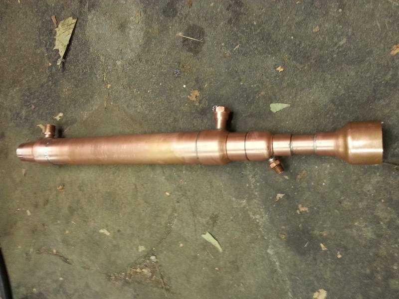

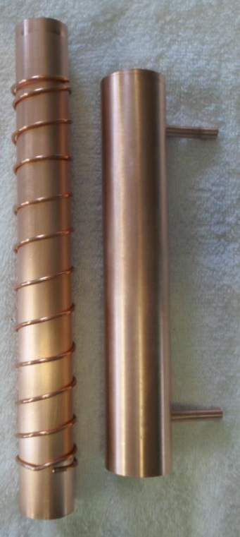

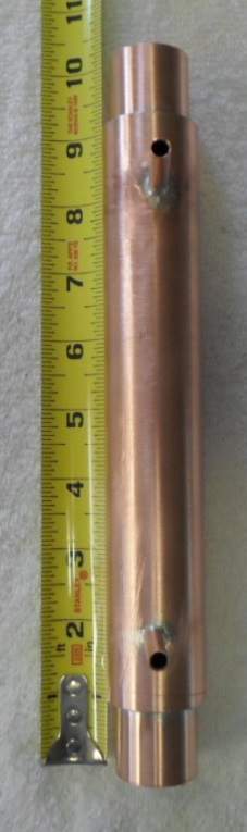

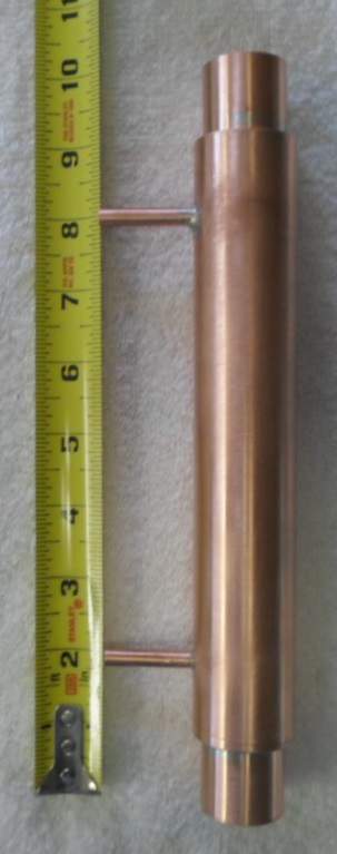

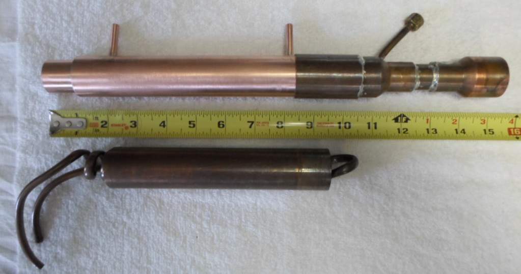

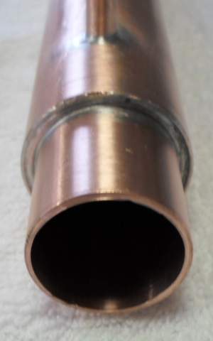

Here is the new concentric (mini dephlegmator) condenser that I constructed, cleaned, and used, yesterday... The parts list is as follows...
8" x 1.25" outer water jacket
10" x 1" inner water jacket condenser tube
1.25" x .25" coolant stubs
12 gauge copper wire (~36")
The 1" inner tube has about 1/2 of a stainless steel scrubber inserted into the upper half of the tube to increase efficiency...

I really like that design very much there Rad...I have originally built your smaller apartment sized hybrid still and it worked great for me, then moved on over to a bigger more basic pot still...but I like the simplicity and compactness of this new build...I am going to giver a try myself and see how it turns out.

The condenser doesn't lean at all, it stands straight up as depicted... It works just as well as a pot still as it does as a reflux condenser... The original head, on page one of this topic, can knock down everything my gas range can throw at it... I have not tested this new condenser insert in pot still mode as yet but can handle power all the way up until the reflux head was on the verge of flooding due to still having the original slanted deflector plate in place, as explained in the link in my signature... In true pot still mode you could also slip an end cap onto the top just as long as you aren't using a needle valve on the output...bluenose wrote:How well with this work as a pot still? As a reflux still? Does it lean more one way than the other?

Threw together the 2" setup last night with a bunch of spare parts. The 2" section i think it 16", total length is longer. For the 1 1/2" tube I coiled 1/4" tube tightly around it, it fits with a little wiggling inside the 2". I slotted the vapor tube at the top and made a point like a Boka, then bent it inward and down to encourage the distillate to drop down the center packing. The center vapor tube is 1" and it extends about 2" above the takeoff point to make a well. With it setup like this I can run any column I like, empty for pot still mode or packed for reflux.
I looked around and I actually have enough parts to make a 3" x 2" x 1 1/2 " setup. I'll make that one shorter maybe a foot. I made this one kinda long thinking it would be more efficient and you could drive it harder for stripping runs. Now I'm in the mood to try it out!!
BTW not shown in the pics I have a cap with a compression fitting in it and two vent holes. The compression fitting with be a guide for a 1/4" tube that will run down the center and thru it I will thread a thermocouple so its right in the vapor stream

Looking good, baron4406...
Can't wait to hear a performance review... I like how you used 1/4" as your turbulator within the water jacket... I'd have gone so far as to use it in place of the reducers as well...
One other thing that I do these days is to trim down my reducers to help keep things light, short, and cleaner looking... Because there isn't any support issues like with full lengths of copper running across ceilings/floors and up/down walls we only need enough copper for the solder to make a tightly sealed join... I then have those small pieces that I can use elsewhere in my many projects... Just tossing that out there...

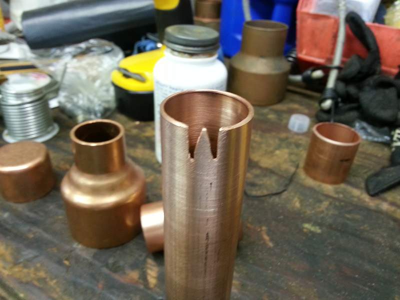

1.) My thinking is that the sizing is more than adequate just as long as there is some type of structured packing in at least the top portion of the inner condenser tube to help slow the vapor speed during the vapor collapse process...
2A.) Either a 1/2" or 3/4" cold finger would work... It would only need to extend part way down into the condenser chamber... Less than halfway down from the top should suffice, and perhaps only 25% - 33%... This figure could be played around with...
2B.) Answered in #1, but you pack the 1.5" condenser tube...
3.) The height of the 1" inside the 1.5" is what determines the collection well and you'd want 1 - 2 ounces of liquid spirits to collect in the well before refluxing, if you are planning on running in reflux mode as well as pot still mode... Therefore the 1" should extend between 2" - 4" up into the 1.5"...
Hope this helps...
Heck, the overall condenser might be able to be scaled down in height by half but we won't know without experimentation... I know that even this last condenser insert I made could be shorter than it is, but I don't know how much shorter... The structured packing really helps improve performance... I'd really like to build another one with downward facing slant plate baffles extending into the vapor flow to see how well that would work...

The issue at hand with this design is that the outer jacket is in contact with the alcohol so it should be either copper or stainless steel... If you look at the concentrics I have constructed you will see that the outer tube is what seals the unit to the condenser head section and the inner tube is actually suspended within the vapor chamber... Don't confuse concentrics with the jacketed reflux CM designs depicted elsewhere in these forums...bluenose wrote:Quick question on this design... since the outermost pipe is the outside jacket of the condenser, does it have to be copper? I've seen some people using PVC or similare as the outer jacket of condensing coils. I suppose there might be problems with getting a watertight seal between it and the middle pipe, but other than that...?

I just looked at your up close pictures and I don't see how the outermost pipe is in the vapour path. It looks like the middle pipe extends beyond the outer jacket at both ends. However, it's your column so you know more about it than me.rad14701 wrote:The issue at hand with this design is that the outer jacket is in contact with the alcohol so it should be either copper or stainless steel... If you look at the concentrics I have constructed you will see that the outer tube is what seals the unit to the condenser head section and the inner tube is actually suspended within the vapor chamber... Don't confuse concentrics with the jacketed reflux CM designs depicted elsewhere in these forums...bluenose wrote:Quick question on this design... since the outermost pipe is the outside jacket of the condenser, does it have to be copper? I've seen some people using PVC or similare as the outer jacket of condensing coils. I suppose there might be problems with getting a watertight seal between it and the middle pipe, but other than that...?
I figured the problem would be more about sealing it, and maybe about the bottom getting too hot near the takeoff.

Ah, I just looked back through the topic and it depends on which pictures you look at... With the complete head at the beginning of the topic the outer tube doesn't every touch vapor... However, you might have a tough time sealing other materials to copper due to differing expansion/contraction rates... For the mini-dephlegmator later in the topic the outer tube definitely contacts the vapor...bluenose wrote:I just looked at your up close pictures and I don't see how the outermost pipe is in the vapour path. It looks like the middle pipe extends beyond the outer jacket at both ends. However, it's your column so you know more about it than me.
@Beavercreek
Copper removes sulfites from the distillate vapor and that is the reason why even stainless steel stills should have some copper in the vapor path... The subject has been discussed countless times...
- Posts: 147
- Joined: Fri Feb 15, 2013 3:40 pm
Re: Concentric Pot/Reflux Still
that makes senserad14701 wrote:...you might have a tough time sealing other materials to copper due to differing expansion/contraction rates...
I was hoping to get away with having the middle pipe be 2"... guess I'll have to go 2" - 1.5" - 1"
what kind off takeoff rates are you getting with yours Rad?
I'm not a shiner, but I play one on TV
- Posts: 20865
- Location: New York, USA
If you want you could try using 1/4" annealed copper instead of reducers... That would save a bunch of money and allow for a more compact size...bluenose wrote:that makes senserad14701 wrote:...you might have a tough time sealing other materials to copper due to differing expansion/contraction rates...
As for take off, I haven't run in straight pot still mode as yet because I've been using hybrid mode for speed and consistency... But with a 1.25" column my ideal take off rate is 1oz per minute with minimal reflux diminishing to no reflux throughout the run...
- Posts: 261
- Joined: Tue Mar 13, 2012 1:53 pm
Bluenose I just set up my 2" x 1.5" x 1" rig to do a shakedown run, its sitting on a 24" column. This will be my "inside" still for my basement electric setup which isn't done yet. I'll be running about 5 gallons of skanky wine, its about 14% alcohol. One thing I noticed, water jackets always fill from the bottom and out the top, and that's the way my liebig on my pot still runs. Also on a still you want the water entering away from the boiler and going towards the boiler. However on a concentric you would have to go in the top and out the bottom. Rad runs his unit that way but I notice on two other concentrics in this thread they run the water in the bottom and out the top. Is there a proper way? Both ways obviously work.
- Posts: 20865
As I mentioned to baron4406 via PM, I do run counter-flow with the water entering the top and exiting the bottom... I usually loop the exit line up over the top line and thought I had mentioned that earlier in this topic because one of the pictures was taken before the line was tied into place...
