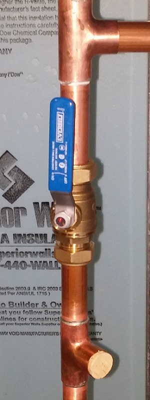

So how about something like this?
8 psi Set Pressure, 3/4" NPT Male x Female
Placed here...
Where the cork is at the bottom has been replaced with another short copper segment and a 90 degree elbow pointing up that houses a rubber cork.
I know the picture shows 20 psi but the ad is for 8psi and I would be sure of that.
Or this.....
Stainless Steel 304 Dual Scale Liquid Filled Pressure Gauge
in the same position.

rgreen2002 wrote:So how about something like this?
8 psi is still pretty high for steam pressure release IMHO... You'd be amazed how long that valve would vent if it were to trip... Some valves only trip and vent until the pressure drops to within manufactured range while others vent until there is zero pressure left in the vessel being protected and must be manually reset...
I just replaced my water heater after it ruptured due to a defective pressure switch for my water pump even though the year old pressure relief valve was working properly... The old water heater tank just couldn't handle the sudden spike from the calibrated 50 psi to 80 psi... The pressure was building faster than the relief valve could dump it so the tank ruptured... Luckily, it wasn't a catastrophic rupture...
Before purchasing a PRV or another method of evacuation HD members should consider the rate at which the device is capable of doing its task as the vessel size should be taken into consideration .

I chose the 8 psi because for some crazy reason the 5 psi one is practically double the price. Since I have a manual valve for pressure release and I am always there when the mash is steaming anyway... maybe a gauge is better for me... I want to see what more people think before I pull this trigger!
real life example. I have a large air over water tank that operates between 55-75 lbs.
blew it down to do some work and when the gauge read 2-3 psi I unscrewed the 1.5"
air bleed valve from the tank, and it was promptly shot through the wall
it took about 2 minutes to equalize to atmospheric pressure through that 1.5" hole.
this is a cold water tank not a steam generator.
err on the side of caution.

cob wrote: real life example. I have a large air over water tank that operates between 55-75 lbs.
Many years ago a coworker was killed opening the hatch on a RR tanker that had been in the hot sun. Size does matter and when in doubt ASK !!!!!
