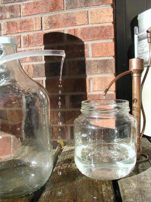

Used the condensor for the first time yesterday. It performed well although I found a small leak on the outer water jacket at the top joint (which was a self fabricated piece so no wonder it leaked there :oops: ) If you have ever tried to resolder you know what a pain it can be. Got nice fat glob on there but won't know if it is fixed for a few days. It holds water now but so it did before. The heat has a way of finding your weak spots!
The water was a slow trickle so I am calling it a success. It is hard for me to compare apples to apples with my old condesor. I have completely changed the whole still set up. I pulled the exiting water hose around so you could see the water flow rate next to the parrot in the picture.
alc. and condensor water flow rate
Pictures FR143 045.JPG (63.17 KiB) Viewed 5316 times
The nice feature of this new condensor is the steam port being at a 90 degree angle and on a bronze union. This allows it to pivot to any angle or height! I can raise or lower it to suit any collection vessle.
