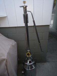

Re: CM Still Output Improvement Mods Mile High / Brewhaus PS
Is there a preference over having the through tubes in line or criss cross? im putting 4 in. Also at first i thought the centering ring was a good idea but now ive seen a few of you say that its not worth it, i dont know what to do anymore, put one in or not. If i dont would it be better to put a slight kink in the thru tubes to at least direct the condensed liqid back down the centre a bit more?
- DAD300
- Posts: 2842
- Location: Southern U.S.
No centering ring it only increases vapor speed and add a scrubbie or some mesh atop the tubes. It will give them more cooling effectiveness.

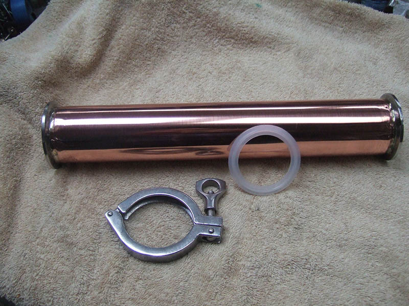

I need some (more) advice. My welding pal has knocked me up a copper extension (picture attached).firewater69 wrote:the external coil works well depending on the size of it and of course water temps also play a big roll. mine is made from 3/8" and when I build another it will be made from 1/2" for more knock down power. and I run separate water tanks for my pc and rc.
I was just going to use it to extend the column, but then the external cooling jacket idea came up. I can't wrap a coil where the current inlets are for the cross tubes. Not only would it look messy, but I don't think it would effective as it wouldn't cover enough surface area. So I was thinking of wrapping the coil around my shorter 6" gin column extension and putting it up top. Despite being told I can just bypass the through tubes, I want to be able to use them both (I will call this 'Reflux MAX'). I've attached a photoshop mock up of my idea.
So my questions are as follows:
Will the total reflux area on a 6ft column be too long with both the tubes and the coil. The total area above and below the reflux stage will be the same - but there will be a much wider area of reflux (apologies if my terminology is all over the place)
Will 5 inches of coil have any significant impact?
With both my new extension and the gin extension, I will 6" longer than the OP's suggested height for a 2" column. Will I suffer any consequences?
Thanks.

one problem you will face is wrapping the coil, the o.d. of my column is 2.125" so I wrapped my coil around a piece of 2.00 material because as you wrap copper around a pipe it will spring out and fit too loose, however if you wrap it around a smaller 2.00" diameter when it springs out it will fit tight on the 2.125" diameter and be more efficient. as far as column height, that's up to you. if your trying to make a neutral, a boka would be a better choice imo. my still head (pictured above) is 16" tall, I also have a 12" extension all fitted with tri-clamps now, and I can achieve up to 92% on a charge of low wines collecting at a medium paced drip, but it still has a ton of flavor, which is also why I love the cm. also you may find 5" of coil is on the small side depending on what size you build it from and how fast you want to run.

If you think you need more cooling there are options... You could run your coolant down through the wound section and then through the cross tubes... You could cut and grind the cross tubes flush with the column and wind copper around that section... Or . . . .

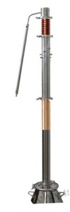

Here is what a did you my still. I got to do a cleaning run again since I welded on a ferrule to get rid of that rubber bung. I can't wait to see how it runs with the plate and packing.
