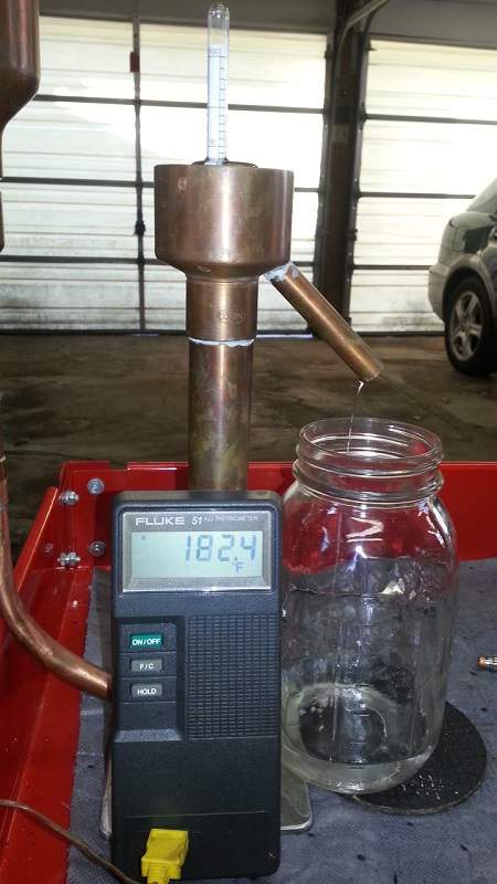

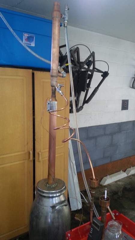

Ok results from the 2 X 1.5 x 1 still test. First off it runs like a dream. Knocks down everything I threw at it with almost no water flow thru the column. I had the 1.5" column stuffed with packing to improve efficiency. Adjusted the water so it was cold at the top, and hot at the product outlet. The stink, bad wine i ran started at 92%, and I only ran about 1.5 quarts but it ended up in the hearts at 85%. I played with it alot. Opened the needle valve and let it rip, then closed it and saw how the column stabilized. This won't be an azeotrope monster, it only has a 24" packed column. Its the height i need to fit in my cellar. Even when I was in the "stripping" mode I didn't have to adjust the water. Still does do some strange things, temp will slowly rise thru the run if I'm running at pot still speeds, ends up over 200 degrees, but the ABV remains rock solid. Probably better to run it a little slower, but like I said this is a whiskey still. Oh by the way, I caught it on fire......... when you have 200ml of 90% in your hand its not a good idea to play with a water valve.......burned off my column insulation. DUH.
So what's next? Looks like a 3 x 2.5 x 2 is next on my list. I may make my upcoming Odin style rye whiskey with it, but i plan on making my 3" Boka my go to still.
Any questions about the run please let me know. Also didn't get my takeoff liebig built in time so I just ran a coil of 3/8" tube like ya see in the pic, distillate was very hot coming out of the still, and 80 degrees in the parrot. I may not bother with the liebig.
Conclusions? it doesn't need to be this long. As wild as it sounds it could probably be half the length and do fine. There is something very interesting about this design. I may build 3 or 4 this summer for fun. What I'm thinking is Rad's idea of stuffing packing in to the vapor outlet of the 1" pipe is the key. When the water jacket cools that copper mesh its like a huge condenser. Just know I'm running city water, you use almost nothing during a run and its fool proof. I spent all run knocking the water back, it was actually a challenge. The spigot at the hose was just open a tiny crack, and the feed ball valve was open a tiny crack. At the product outlet it was very hot to the touch, 3 inches up it was ice cold. Also keep in mind I was running way too much heat, next run I'll back off the burner to almost nothing. This , in my mind, blows the holy grail of starter reflux stills, the Boka.........out of the water. Construction is alot easier. And you need decent water pressure to get thru a double wound 1/4" coil, trust me I know. You could run this concentric with the tiniest water pump and be fine. With a proper size column this would make a great reflux still.
On to the 3" size build, I'm gonna make that one as long as this one is. So any of you on the fence what are you waiting for?

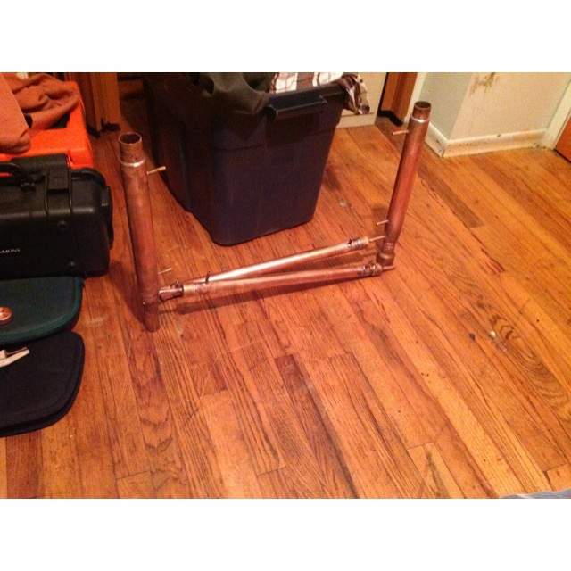

I had twins. They are based on rads apartment still and have concentric condensers.
And yes I know the output condensers are massive for these tiny stills, the copper was already cut to that length and it was free so I didnt change them. Still need to add some reinforcing due to the length of the takeoff condensers.
The large gap in between the head and the take off condensers, is so that I can add needle valves in the future if wanted.
