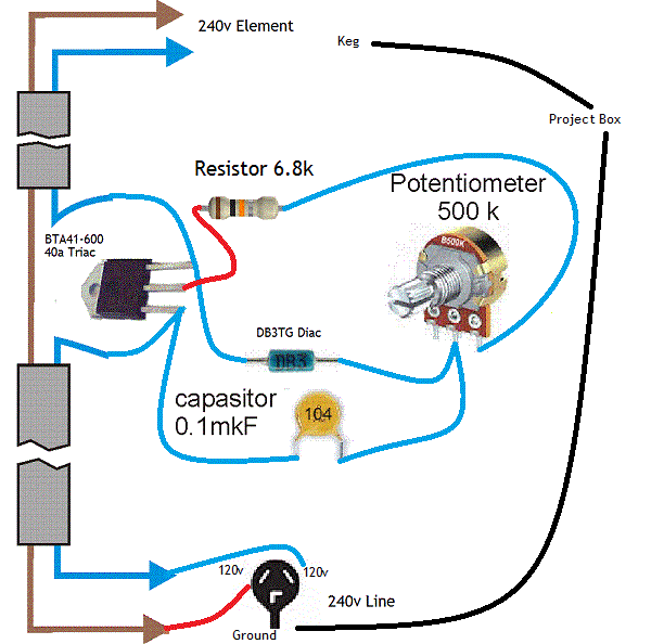

I modified Odessa's original schematic with the common model #'s of the DIAC and the TRIAC - wanted to get a thumbs up from those of you who have a better grasp of this.
Thumbs up or am I gonna let the blue smoke out?

Zzyzxx71: Everything looks fine, except you may find that that 10k resister is a bit too much resistance to achieve 100% power, if not try a 6.8 k or so...
By the way in the pic you have the center and left connection used on the POT (as viewed from the front of the POT as in the pic), this will turn down the power as you turn up the POT, using the center and RIGHT connections would be the normal way of connecting it, and it would be best to terminate (connect) the (unused) left connection to the center one then as well, doing so helps reduce "noise" on the POT and makes for smoother control.
And the extra 1m resister(s) across the POT are for "EXPANDED RANGE" not linearity. It reduces or eliminates the "dead area" on the pot from min to whenever it comes on, thus giving the control over the whole range of the pot instead of just a portion.
Using a "LIN" POT (linear taper) as apposed to a "LOG" POT(audio taper) will make the control LINEAR.

Centar wrote:Zzyzxx71: Everything looks fine, except you may find that that 10k resister is a bit too much resistance to achieve 100% power, if not try a 6.8 k or so...
OK lets play "Will Zzyzxx let the blue smoke out part duex.."
Below is how I currently have it mocked up (without the actual power line in place). I made the 3 adjustments recommended (Use of a linear pot, connection to the alternate lug of the pot, and use of a 6.8k resistor in place of the 10k)
Is this valid? I'm making the assumption that where indicated in the original schematic a component is connected where it would appear a wire is located, it's safe to connect to the eventual next connection (leg of next component).
If this should turn out to be a valid configuration, here are the parts listed - all from Mouser.
Potentiometer
Mouser #: 785-380C1500K
Desc.: Potentiometers 500 K Ohms 10% 2W Solder Lug
Capacitor
Mouser #: 647-QXK2G104KTPTZH

One thing that jumps out Z is that your brown wire shouldn't be ground, it should be one leg of your 220V. Don't jumper your two hot legs together, that would cause problems. Run your ground wire directly to your hobby box (if metal) and then on to the boiler. In the end, you want both hot legs of your 220V connecting to your heating element (one directly and the other through your control components).

mtnmann wrote:One thing that jumps out Z is that your brown wire shouldn't be ground, it should be one leg of your 220V. Don't jumper your two hot legs together, that would cause problems. Run your ground wire directly to your hobby box (if metal) and then on to the boiler. In the end, you want both hot legs of your 220V connecting to your heating element (one directly and the other through your control components).
mm
Schematic adjusted. Please advise.
Adjusted Schematic
Adjusted Schematic
Centar
Posts: 84
Joined: Fri Aug 13, 2010 2:57 pm
Location: Canada
Re: Heating Element Control
Post by Centar »
Zzyxx71: To my knowledge a 240 VAC Socket in north America had GND, neutral,120, and 120 opposite phase on a dryer or stove socket. (4 connections)
You want the GND, neutral and either of the 120 connections.
If your out side north America the two holes are 240 and the 3rd (in the middle) hole is GND on a regular wall socket.
The updated schematic works if your out side north america.
I have added one SMALL addition to the circuit (black line) on the POT, this is the connection to keep the noise level on the POT down and makes for smother control....as small detail but usually overlooked even on a lot of "factory" gear...

I live in Virginia, the dryer outlet only has 3 prongs - I ran a multimeter on them last night, both the positives are 120v lines.
The graphic representation of the plug matches the plug of the dryer I plan to take offline for my runs.
Please advise as to what needs to be done to make this work for a US 240v line.

Noticed another mistake on the drawing and corrected it for you...the wiring of the TRIAC was wrong....
Everything should be as simple as possible, but no simpler.

What do you measure between the 2 NON ground connectionson on the the socket, on the AC scale of your meter? (there is no positive or negative as this is AC not DC)

Zzyzxx71 wrote:I live in Virginia, the dryer outlet only has 3 prongs - I ran a multimeter on them last night, both the positives are 120v lines.
240 outlets will read 120 from each leg to neutral/ground read across both should 240

Centar wrote:What do you measure between the 2 NON ground connectionson on the the socket, on the AC scale of your meter? (there is no positive or negative as this is AC not DC)
240
Centar
Posts: 84
Location: Canada
Post by Centar »
OK, it appears that you do not have a neutral connection on that socket, just the 2 120 phases (180 degrees out of each other so you measure 240 between them) and the GND.
The Circuit wiring is correct for this in the drawing.

Hrmm. Just finished building my Odessitt controller and im not getting any voltage change. It just sits at 230v regardless of where the POT is. Anyone have any ideas?
Filby
Posts: 88
Joined: Mon Oct 04, 2010 7:31 pm
Location: South Australia
Post by Filby »
Think I found the problem. The guy gave me a 500ohm instead of a 500k POT. grrrrr
Posts: 20865
Post by rad14701 »
Filby wrote:Think I found the problem. The guy gave me a 500ohm instead of a 500k POT. grrrrr
That'll definitely do it... :esad: At least that won't cause any of the magic gray smoke to escape, rendering components worthless...
