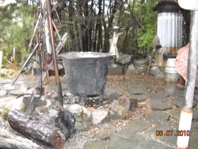

food for thought ...reading heaps in here learnin to build a pot still ..
being in a rural enviroment all sorts pop up in farm backyards here in kiwi land ..these little fellows are found inside an undersink water cylinder for a house ..they come in all sorts of sizes ..i wrecked this out taking off the galvy outer cover ridding the insulation and out popped this all copper vessell.hasnt found a home for a build yet ..but im thinkin could be a cool lookin wee thumper for my alembic im workin at finding plans for ..hope this helps somebody here ..
i have many water cylinders here too i kept over the years and wrecked out they come in all shapes and sizes and have already very cool rounded end pressings on them and quite a few copper pipes inside them for there ins and outs perfect for columns possibly ..
we call this stuff kiwi enginuety eh kiwis lol
the other pic is an old copper that used to be set in a concrete type tub they used to boil the wasking up or ya pigs or a huge soup lol
wreck out the concrete bit and your left with a beautiful pressed piece of solid copper that looks like a top hat..reckon 2 of these stiched together could be a very cool start to an alembic
have made dies etc and forged and formed precious and non precious metals ..figures these wee beast have had alot of work done to shape them to get you started ...who knows ?

Oh that wee cylinder makes me week at the knees.
Great find.
Great find.
- Posts: 1283
Re: Thumper?
Its like a puppy...I just want to take it home and make it my own.

cool isnt it and yet they are quite common in houses over here and easy to find ..oh and rubber duck that one in the backround (last Pic)is called Ned Kelly lol ...its another water system i built all plumbed up to a header in the tree and an outside shower .its wrapped with corry iron and ya light the fire under it its a weapon and just for the hell we stuck a whistle on top ..itll boil flat out in about 2 hrs
