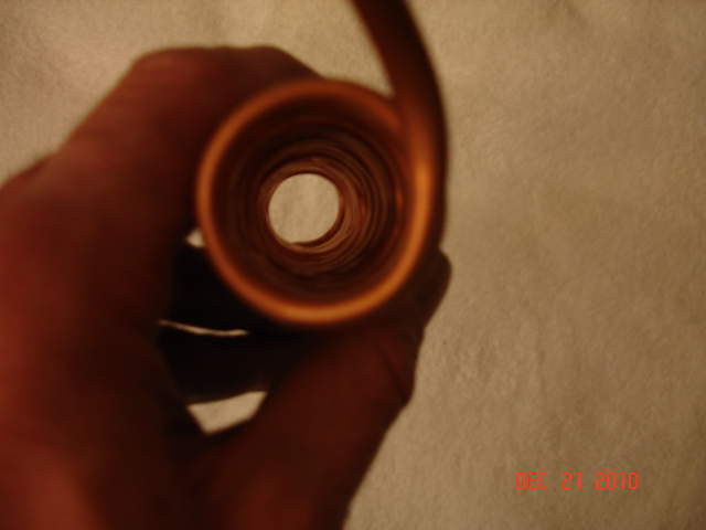

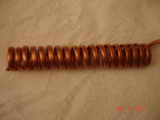

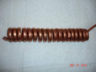

Well, my wash is just about done, and I've gotten everything built except for the condenser coil, which is really kicking my ass. I don't know if I'm using the wrong copper tubing or what, but I just can't seem to wind a coil that doesn't flatten out and also get a kink or two. Blowing through it tells me that there is just too much restriction there to be functional. Is there a difference in 1/4" OD copper tubing? The stuff that I'm using is "Watts" brand copper tubing. The label says "General Purpose Copper Coil", and is made in China - like everything else nowadays.
Although it's not what I do for a living these days, I've been a Master Automobile Tech since I was 17. I'm sure that I've bent at least hundreds and hundreds of feet of different types of tubing before, for anything from brake lines to diesel injector lines, and I've NEVER had this much trouble. I've even done lines for expensive restorations and have always been told that my lines look "factory" bent. I could bent this in stainless or coated/galvanized brake line without even trying that hard. Why am I having so much trouble with this little 1/4" copper line?
Help...
thanks,
Seaside

Seaside, there are several topics which cover winding condenser coils here in these forums... What size column tube are you trying to wind your coil for...??? I'm pretty sure I wound the coil for my 1.25" column using a 5/8" mandrel... I wound directly off the coiled copper I purchased without straightening it first, which would have work hardened it, and it wasn't filled... I only got very minor flattening... I have wound 1/4" using a 3/4" mandrel the same way an haven't encountered any flattening at all, as you can see earlier on in this topic... There may be two different types of 1/4" tubing and perhaps I've just managed to grab the right stuff every time I've gone into a hardware store...
It can be done... You just have to become one with the copper... If you fight it, you'll end up with kinks and/or flattening...

I know. I think that I've read most (if not all) of them.Seaside, there are several topics which cover winding condenser coils here in these forums...
I'm using 1 1/2" for the column, since you said that you'd probably scale it up a little if you had it to do over again.
Same here. I left it coiled too. I used a 3/4 inch mandrel and used the 12 ga. solid copper wire for the spacing like you did. (Good idea on the spacing wire too, BTW.)I'm pretty sure I wound the coil for my 1.25" column using a 5/8" mandrel... I wound directly off the coiled copper I purchased without straightening it first, which would have work hardened it, and it wasn't filled... I only got very minor flattening... I have wound 1/4" using a 3/4" mandrel the same way an haven't encountered any flattening at all, as you can see earlier on in this topic...
I sure hope so, or I'll just make it out of stainless...There may be two different types of 1/4" tubing and perhaps I've just managed to grab the right stuff every time I've gone into a hardware store...
Oh yeah, I was "one" alright - one pissed off SOB.It can be done... You just have to become one with the copper... If you fight it, you'll end up with kinks and/or flattening...

No, you don't need an external photo hosting site to post pictures... There is a section below the post editing Submit button where you can add attachments... Once uploaded you still need to insert them into the post... There is at least one tutorial somewhere in these forums... HERE is one of them...
Using water won't help at all unless it is frozen... I just work very slowly, using even pressure, never apply force from more than an inch or so away from the mandrel, and only apply as much pressure as my thumbs can muster...
I'm pretty sure I read here somewhere about a member actually getting copper too thin to wind without excessive flattening and kinking...
One thing to consider when winding... As the copper winds around the mandrel it generates heat, which is part of how it work hardens, and if you go too fast the heat will build up too much at the fulcrum point and the unwound copper ahead of the fulcrum will not be as flexible and will provide the leverage that causes the kinking either at the point where the warm copper meets to cold or where it is the warmest, wherever the molecules are the most active... Think of it as the kink occurring at the hot-spot, causing the hot-spot to get even hotter, which causes more kinking and on and on... I'm only surmising that flattening is merely a precursory alternative to kinking...
