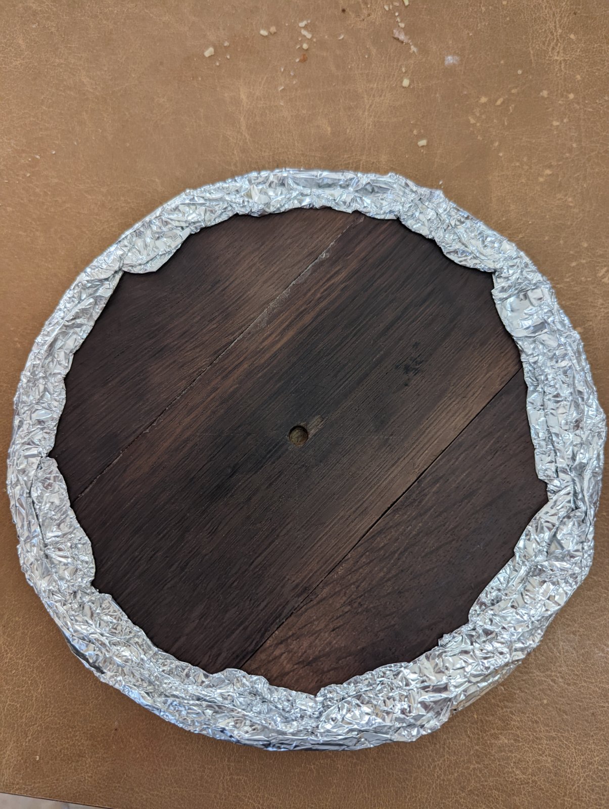

At it again. I find the old George Foreman at setting 4 hovers around 200c.

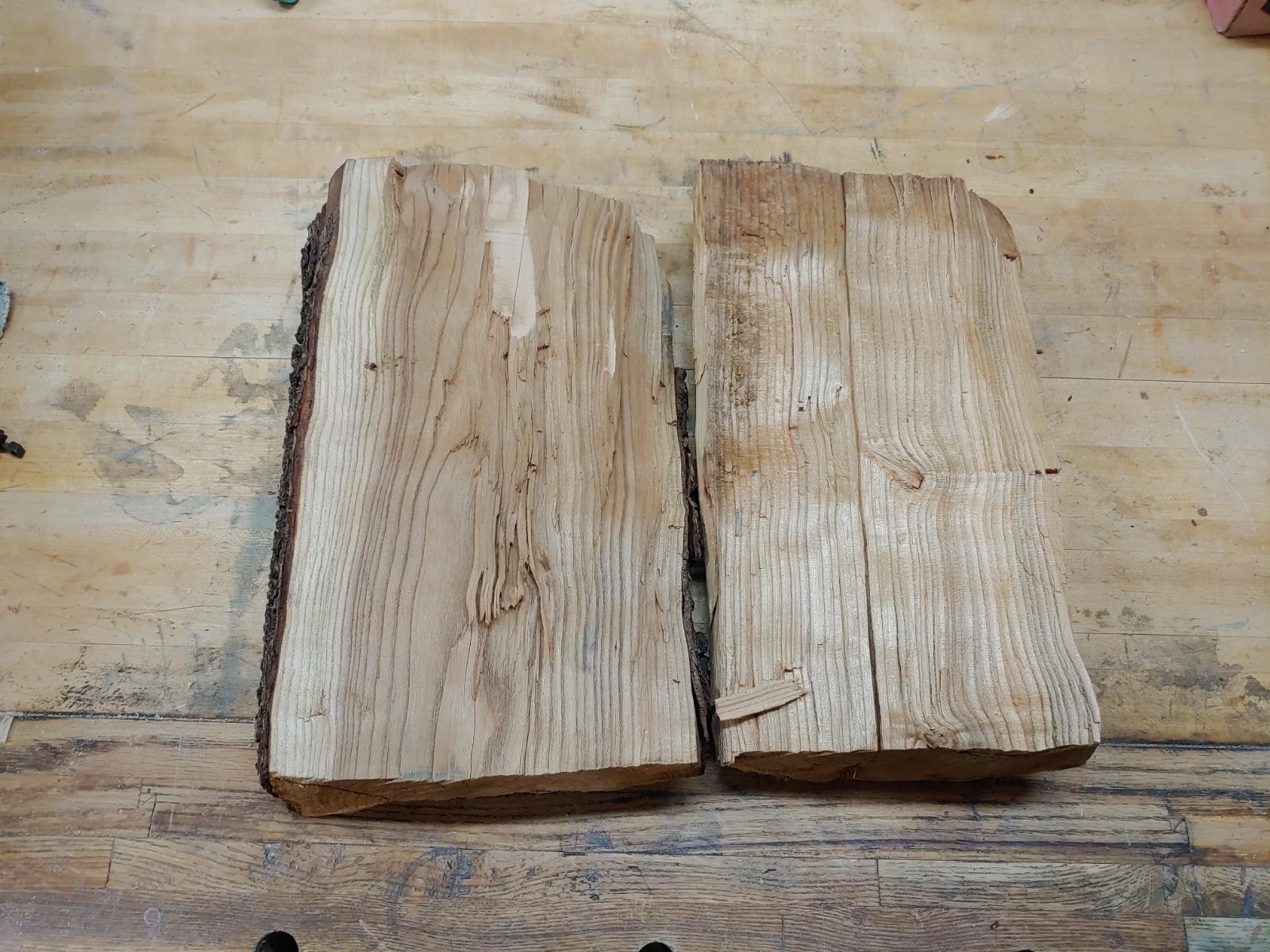

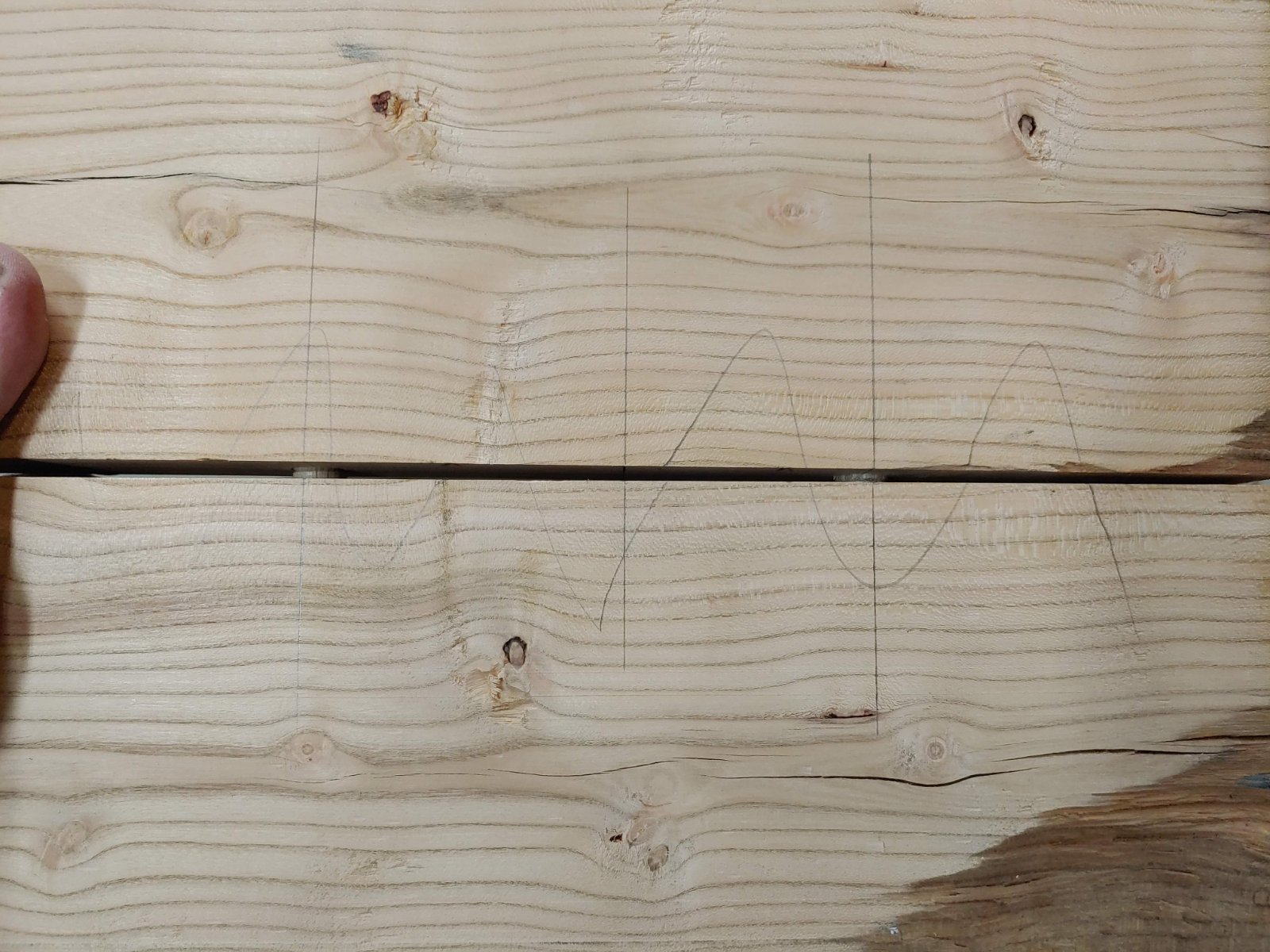

Thread inspired me to build one, I used some nice seasoned peach I split out for this purpose and yard aged.

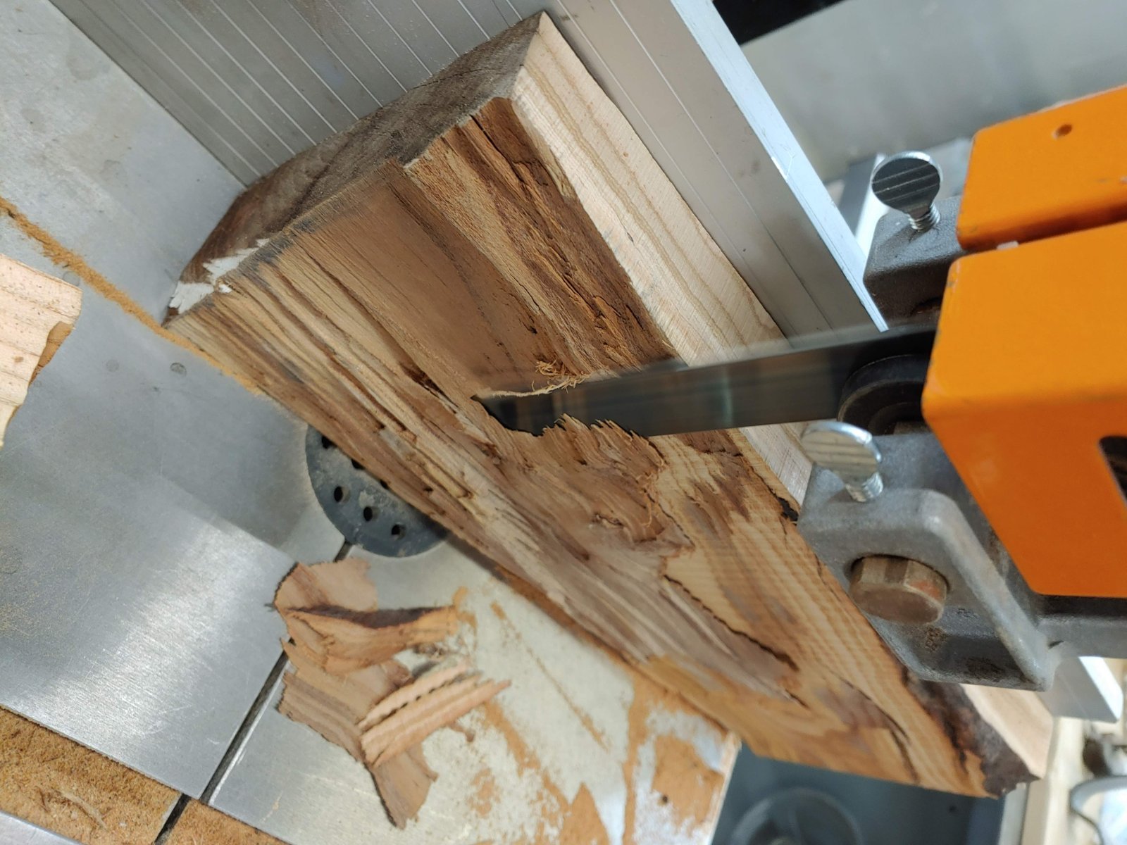

Preflattened on bandsaw with resaw blade
Final flattening/squaring with planer/jointer

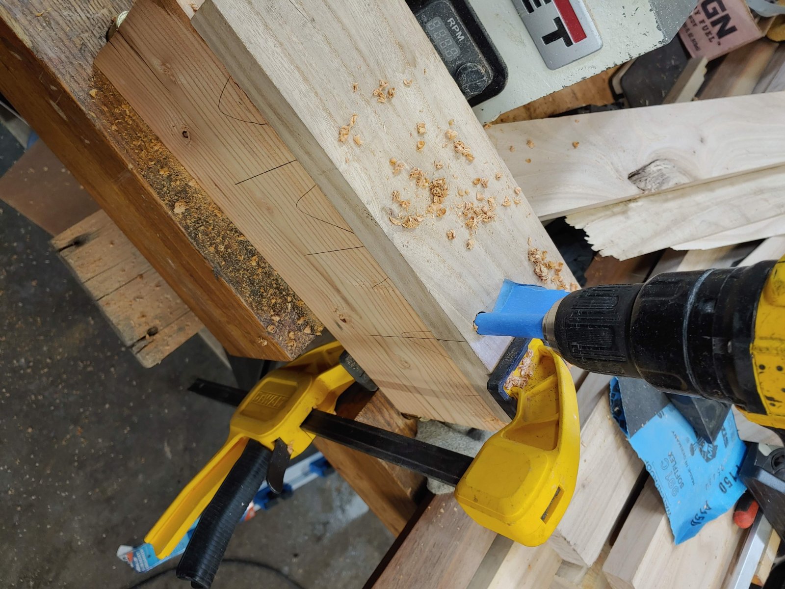

I never use dowels on anything, but they made sense for this. I didn't have any on hand so I made a hole, measured and cut some 0.005" larger than the hole so I would have a nice hammer fit without splitting lumber.
As I said, I don't use dowels, so I used a chunk of scrap to make a jig, and a piece of tape to mark bit depth.

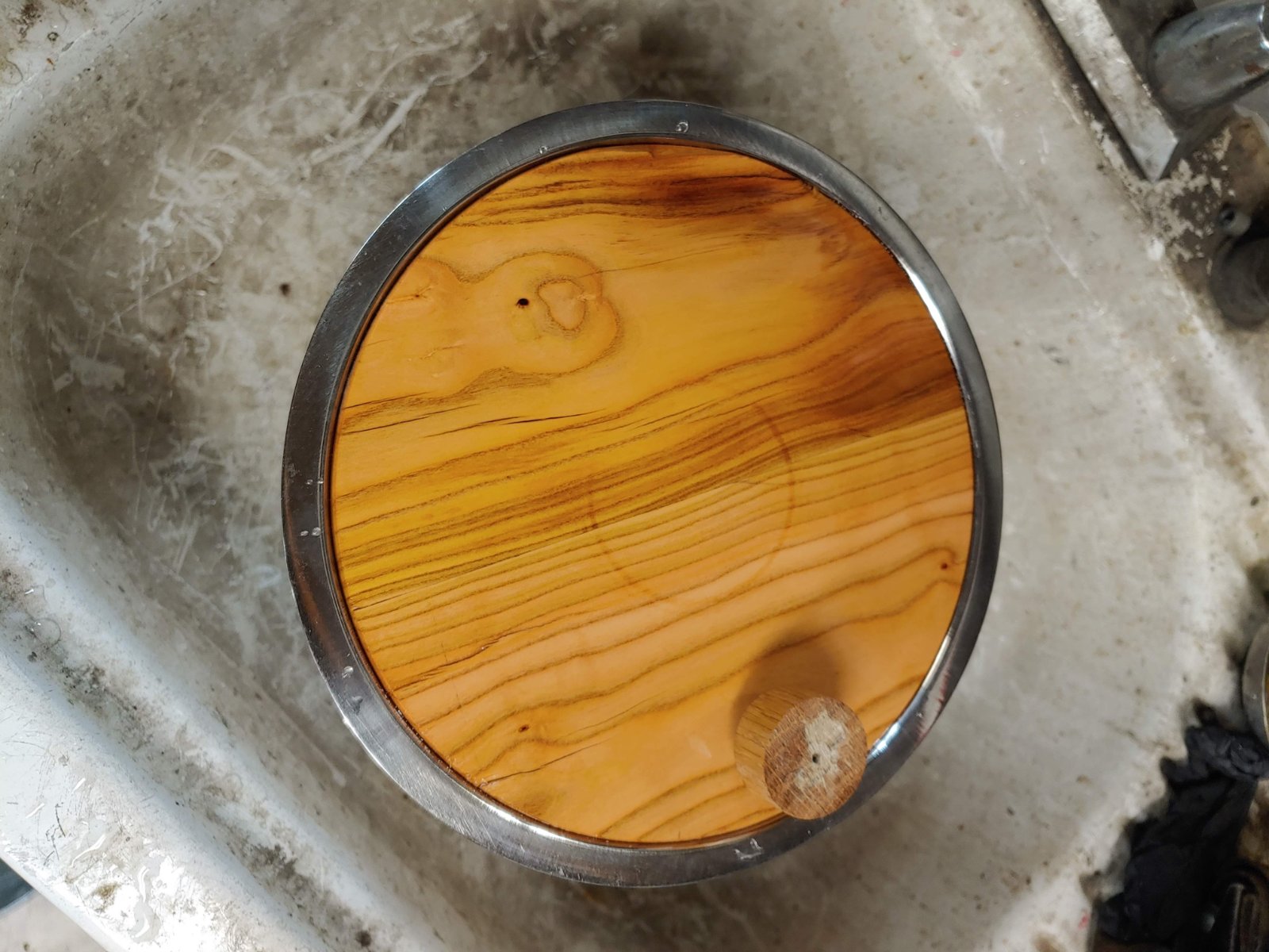

Fit everything up, very happy with the dowels and jig, requires a mallet but no sign of splitting.
This allowed me to rough out on the bandsaw and chuck into lathe for final shaping. No glue required and the pieces didn't fly across the room! Drilled a hole and made a bung plug from a scrap of oak.
Test fit looked good. Its swelling now. Once I am happy the fit is good I will sand off the little blemish from lathe jiggery. Maybe do some laser engraving.

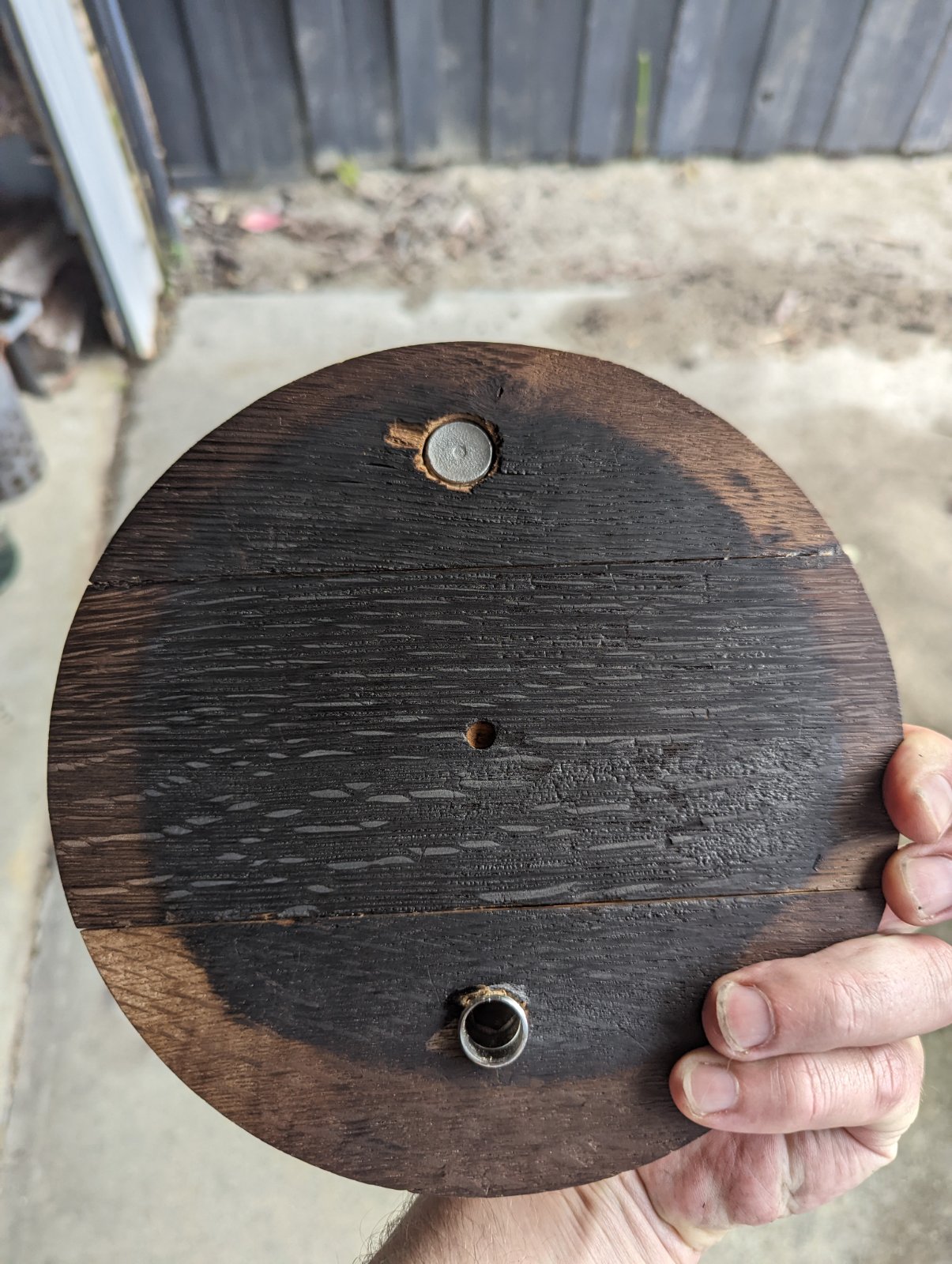

I used a vevor engraver for the markings. Not really sure on naming convention for char etc but it is just for me so it doesn't matter!
Loving that peach wood one! I've got some cherry here that may have to go out in the yard for a few years seasoning!

The peach one was a bung only and looked more my style as im hoping to make a few and leave them a while
- subbrew
- Posts: 1543
even easier than a bung is to just use a stainless steel bolt. I got a half inch bolt, drill a slightly undersized hole and thread in the bolt. After going in an out a few times I have had to put a little bees wax on it to maintain the sealicrazy wrote: ↑Sun Dec 04, 2022 2:23 pm Can this be done with just a bung im thinking of giving an old barrel lid a go ive just ordered 2x 7.8ltr bain marie pots figure one for rum and one for single malt barley done with yellow label angel yeast.
Dont feel i need the tap as i can sample through the bung hole using a glass basting tube
