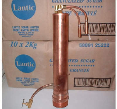

Here are some pics of the last VM design rig I built ..cant take the credit for the design (thanks Harry for sharing your ideas) I did do some slight mods from the original design . I had intentions on making a pic tutorial on this build but have not got around to doing that yet .Dont have any yet of everything assembled. But I thought I would go ahead and post them here . . there are several of them . not all that big of files but could pose a problem for the dial up users .. if it slows the site let me know I will remove them of a mod can remove them.
NM
edit here is a template I added to Harry's original design should be to scale if printed with windows picture and fax viewer

Very nice work.
I see you added the slant plates for foreshot removal.

I swear to god I am not trolling... but what does VM stand for? I googled it first and found nothing... the only thing I can come up with is "Valve Modification"... or "vapor mast"... neither seem good enough to explain what this is.
That being asked... it looks dead sexy... what is the black stuff hiding all the pretty copper?
LOVE the case it goes in... really cool... in fact I see one of these in my future.

ImaDKrook
Posts: 72
Joined: Tue Aug 18, 2009 5:44 am
Foreshot removal
Post by ImaDKrook »
Postby Hawke » Wed Aug 12, 2009 12:49 am
Very nice work.
Help me understand. In relation to the plates and valves. :?:
Krook
new_moonshiner
Posts: 964
Joined: Sun Jan 21, 2007 7:15 am
Re: VM Project
Post by new_moonshiner »
With the gate valve in the closed position the slanted plates work just as a LM rig would with everything being taken off from the smaller (brass Valve) ..Im just using Harry' cross flow condenser idea (slight variation )..for the condenser..
The procedure in operating the rig is to use the LM (liquid management ) operation to remove the foreshots and heads which is collected from the smaller brass valve .. once they are removed , then you can close the valve and switch to the Vapor management side using the SS Gate valve
To remove to hearts which should not have any contamination from the fores and heads . the rig is still sending liquid down the packing during this time ( it overflows on the bottom plate because the valve is closed) and you open the gate to remove a percentage of the vapor which is condensed in the second (liebig) condenser ..
edit Oh yeah I almost forgot the black stuff hiding the copper is insulation under several rolls of electrical tape. not only does it insulate it protects from dents and bruises as well.
here is the adapter I use to connect to keg with also .

ImaDKrook wrote:
new_moonshiner wrote:With the gate valve in the closed position the slanted plates work just as a LM rig would with everything being taken off from the smaller (brass Valve) This I understand.
The procedure in operating the rig is to use the LM (liquid management ) operation to remove the foreshots and heads which is collected from the smaller brass valve .. once they are removed , then you can close the valve and switch to the Vapor management side using the SS Gate valve Here is my point of confusion. There is no slant plate here. :?: You are taking off Vapor? Then Condensing with Liebig.
To remove to hearts which should not have any contamination from the fores and heads . the rig is still sending liquid down the packing during this time ( it overflows on the bottom plate because the valve is closed) Understand this also and you open the gate to remove a percentage of the vapor which is condensed in the second (liebig) condenser .. Here is the Product/heart cut as a vapor condensed in the Liebig Then onto a jug. I was thinking you were taking off a liquid and was as confused as could be.
Sorry to beat it to death but I wanted to be sure I understood completely.
Answer"
yes closing the small valve )brass one) and opening the gate way SS large one .. and then using the second condenser (liebig) to condense the vapor.
Answer:
I do take off and remove the liquid but its done with the small brass valve this is the one with the slant pate . look closely at the pic you should see the plates outline .. when i finished taking off what i want with the small valve I close it off completely .. not used anymore during the run .. then everything from here on out goes through the liebg
I should have mentioned that I have two slanted plates reason being I have liquid coming down from both sides of the condenser with the TEE design ..
Last edited by new_moonshiner on Mon Sep 07, 2009 5:59 pm, edited 1 time in total.
ImaDKrook
Posts: 72
Re: VM Project
Post by ImaDKrook »
I see one slant plate for thermometer well. The well is underneath the slant plate. There is also a second slant plate for the takeoff. This would be a liquid. All cuts as a liquid. This is a different design than what you are doing? If so which is best?
I am finally understanding you were taking off as a vapor. Initially I was convinced you were taking of as a liquid. I could clearly see there are two plates.... Read your edit above and don't feel so dumb now... ok still just a little.
Sorry to nag but I want my equipment to be correct. :oops:
Krook
Photo borrowed from http://homedistiller.org/forum/viewtopi ... =17&t=5829
new_moonshiner
Posts: 964
Re: VM Project
the condenser at the top condenses the alcohol vapor, any condensed vapors (liquid alcohol) that drops from the coil (top condenser) hits on the first plate forcing it onto the second plate .. any liquid that misses the first plate will hit onto the second plate .. this is where I was talking about a long drop higher the drop the more its going to splash .. everything ends up on the bottom plate . you want a little space between the plates .. closer they are the more restriction for the vapor to make its way to the cold condenser coil. you are creating ..
Then either you take off small drops at a time ( more reading required ) or leave the valve closed and once it fills up the the notch in the plate it drips onto the packing ...( full reflux ) everything goes onto the packing . nothing being taken off .
now which design ? I cant answer that. its what you like. most of us think we have the best design that we could have for the most part .. but in the end we get the same result . the pic that you just posted will be simpler to build than the rig I posted by far .. have a look at those links to Bokakobs designs and maybe get some better ideas of what would suit you and your skill level...

Wow, what a nice job. Two questions: what solder and/or brazing rod, flux did you use for this build? Also, just out of curiosity, why did you opt for the slant plates instead of the dam in Harry's design?
Your system of placing the round plates with the 21 holes slightly inside the tube makes a lot of sense because when you solder on the end caps, there's no chance of melting the solder on the inside.

All of the solder joints were made with sil-fos 15 percent silver refrigeration solder as we call it .. WITH the exception of the two caps that went on the ends ..those were made with soft lead free solder .
My thinking was it would be so much easier to remove the soft solder if I had problems that it would be the hard solder .. also using the soft solder for the caps you are not running the risk of having the plates loosen and leak...
One of the thoughts on the plates instead of the dam, was I like the idea of being able to drop everything out of the well if need be , the valve is in the lowest possible point in the well.. For me the plates were easier to solder than the dam method would have been .. but we all have different thoughts when it comes to this stuff.
I would like to thank Harry again for sharing his idea on this design , and some other suggestions as well with the liebig . I for one respect people that have a genuine interest in developing new ideas and better ways of doing things when it comes to this hobby/art. ( and sharing them for free )
Opposed to some looking to make bucks $$ or passing things off like its Government top secret information,

Did you use the silfos without any flux? Also for the spaces on the 2" discs around the 21 tubes, what size silfos 15 did you find best, .125 or .062? I just completed brazing 3" discs for a tube and shell condenser using a flux coated brazing rod, Safety-Silv 45 which is also very expensive. Seeing your results with silfos, I think I'll try it on future projects because your results look so nice and because of price.

no flux at all with the silfos. I have used the sticks you are talking about that have the flux on the sticks orange and pink colors I think .. But in this case I found the plain 15 percent rods worked fine .. the 45% solder I have used as well , not a good application for this project .. only flux that i used was on the soft solder connection...
lso something to keep in mind when soldering all those tubes together to the plates is, try to solder the plate as one .. not a small sharp flame but something like a turbo torch , once you get the solder flowing it will flow to the joints .. keep the flame moving around all the time and all over the plate, then when you get ready to solder the plate in place apply heat from the outside , with the solder stick on the opposite side ..

Thanks for the advice. I'll get some silfos. I had solder problems on the crossflow I built a few months ago and ended up brazing on the endcaps which were butted to the 2" disks. I put the dam in mine and made the rig modular so I can remove the section with the 1 inch gate valve that goes to the liebig. I mainly use it on a short column (about 1 foot high) for stripping and final runs for rum and whiskey. It works great and I too would like to thank Harry again for sharing his design.
