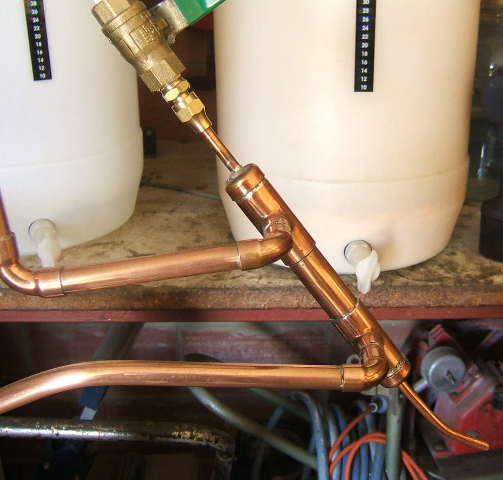

That's the way it is, most of us have built a small inline leibig onto the output tube.

Here's mine
Close up of the mini-leibigOLD DOG LEARNING NEW TRICKS ......

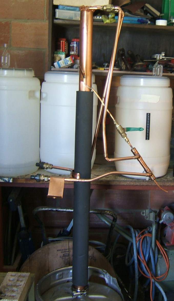

That's mine, very compact.
It's still hot, had two runs today, UJSSM and rum.
