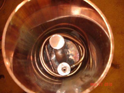

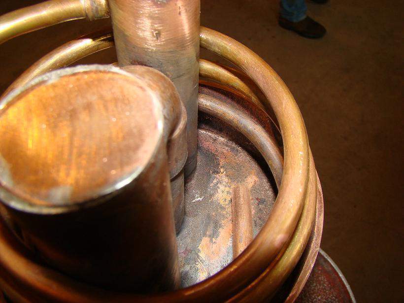

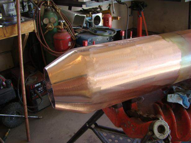

Here's some pictures from today's work, still have a ways to go yet. I will be welding a 4" tri-clamp to the reducer piece so that I can connect it to my turkey fryer. The other piece you see is the guts or heart of the still. Once I get the steam coil attached to it (primary coil) it will be getting dropped down the tube and soldered in place. The coil you see wrapped around the heart is the secondary cooling coil that condenses the alcohol vapor into liquid..
this is the heart of a ponu before the primary and secondary coils are brazed on.
that is the heart of the still, made to slide in.  Later down the road the copper plate will be soldered inside.
finished reducer, cost...zero dollars
some basic pipe fitter skills had to be utilized.
6" x 4" reducer costs $260.00, so I'm building one for free.

ozone39 wrote:6" x 4" reducer costs $260.00, so I'm building one for free.
That is some nice fitting and good for you.

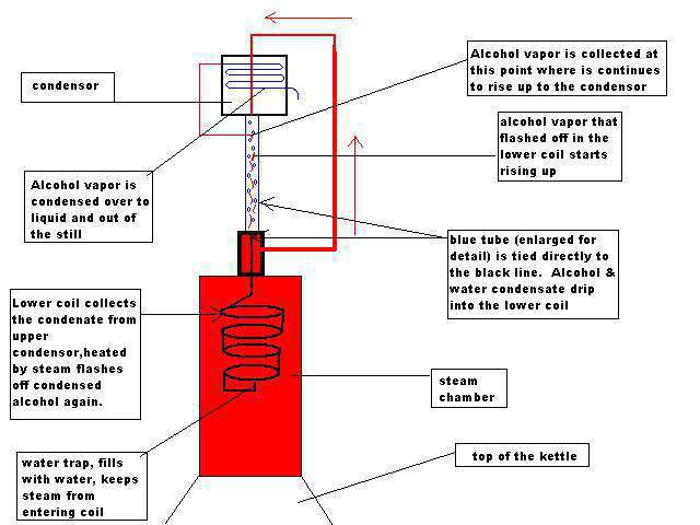

I still can't figger out how this design works, can you post a small draft, please?

This is the basic design. Only change I'm making is the long 3/4" pipe on the right hand side is now going to be inside the cooling chamber inside the still.

The draft helps a lot, thanks O.

Interesting design, what's the purpose, I mean what does it do differently? Thanks.

Flashes off liquid into vapor two times (I'm shooting for three times on this one) before exiting the still. Each time it flashes off you get a more pure product (another level of stripping). Another bonus is this design gets more efficient the hotter you get the steam chamber, were as my reflux column gets less efficient the hotter it gets (packing gets hot and lets more water vapor by). My current Ponu still I'm running starts off with a lower alcohol output (around 75%) as that lower steam coil starts to get hot it jumps up to around +90% and stays there until the tails. I will post one my distilling sheets when I get my new one up and running. This has a time over production chart on it that I use to keep records on still temps and cooling rates v.s. alcohol output. Another bonus is no there is no packing that has to be replaced or cleaned.

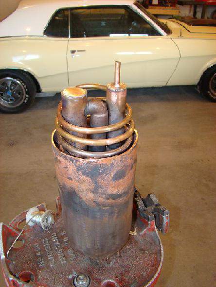

Here's an update of today's progress...Lower steam coil (8 feet worth) is silvered into place and the internal guts were dropped in and silvered into place sealing off the top chamber from the lower. Still trying to figure out how to post pictures in order of operation :evil:
a half way built ponu...cooling chamber is next.
steam chamber view.  next stop, the walnut blaster to clean off excess oxides.
internal silvered joint, talk about applied heat needed,
getting my cut line established..
heart of the still
heart of the still

Looks really good what you've done, I still don't get 100% of the function but trying to understand.
Can't await results and I love the convertible in the back (looks like mid seventies). 8)

I'll throw the schematic on this post. It's floating around somewhere else on HDO I had posted it earlier, but it's probably easier to see and understand with the pictures...
thinking inside the box is for squares....
