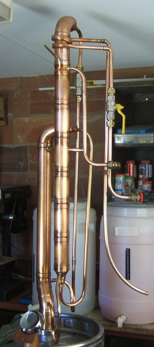

With a dephlagmater on the top of the second column the output will remain at a constant ABV like I have achieved with the Flute design. The original Evil Twin design operated like a potstill where the alcohol percentage decreased as the run progressed, a dephlagmater would fix that problem. I did try a couple of turns of half inch tubing around the head of the column which improved it but not enough.
Evil Twin plated 2"columns
OD

Here is a pic of the whole kit and kaboodle.
whole rig
whole rig
and here is one of the liquid return.
liquid return
liquid return
Since it's St. Patricks day I'm going to go out and party the rest of the night after a few more posts. This is what i have left.
1) Get cork to seal my tri-clamps furrels and heater-element.
2) clean run with vinegar/water and check for vapor leaks. I've been checking with water after almost ever soldering session so i know it's atleast water tight!
3) 2nd cleaning with my "heads and fients"
4) break her in and find out if she's build for pleasure or build for speed. :lol:
5) make up with my girlfriend for all the evenings I've retreated into the basement to work on this still! :lol:
Let me know what you think!!

It looks dandy, GM !
Will look forward to your production reports!

Here's an update of the progress of this still.
Currently I have 10 gallons of UJSSM in two 5gal buckets that I started last night. Modifications of note are that I inverted 5lb of sugar with one 1tsp citric acid per bucket. I also added 1 gallon of properly enzyme mashed corn sugars to each 5gal bucket to add more flavor to this first generation run and this was stirred and final SG was adjusted to 1.090 with a little more sugar. I also added 1tsp of epson salt per 5/gal bucked as it seems to work well in the birdwarchers i've made. Lastly I used distillers yeast. I mention all this for later flavor comparisons of this UJSSM through the still.
This afternoon I had time to get a little aquatinted with this still by running water to test for leaks. I found several pin hole leaks that I had to repair. After those repairs and looking at the clock I realized that I wouldn't get to run my Uncle Remus rice vodka mash that I made for final cleaning purposes... So I decided to push her with water vapor and see what I can get out of her that way.
initial results with the water are very promising. My 4500W 220V boiler brought 10 gallons of water to a simmer in a little under half an hour on around med-hi setting. Once I noticed the base of the still starting to warm up I turned the heat down to med-low. About 35 minutes later the first drops of water came out of the condenser. A little after this I noticed another small leak I missed so I turned to power off and soldered it back together.
This time, with a warm still, it literally took only 3.5 minutes for water to drip out of the condenser. While at a low take off rate I put a dry town against the hot copper pipe, leaned over, put my ears against it and listened. I could hear the sound of plates bubbling in the 2nd pipe (one with the delph), and maybe two plates in the first. Both pipes were not bubbling much by the sound of it but then again it was what i heard through a towel too. I then decided to turn the power supply on a higher setting and see what kind of take off rate I could get on water. I slowly turned up the heat as high as I could without creating a rolling boil in the boiler. At this heat I initially had steam coming out the condenser but increased the cooling water and it compensated resulting in a nice steady flow. I timed how long it took to fill up an empty 12oz beer can and it took 4m35s. lets round up and say 12 oz in 5 minute, thats 36oz in 15min and about a gallon & a pint an hour! :D :mrgreen: :D (with water in the boiler). Before switching experiments I listened to the pipes agains and still heard reflux sputtering away. :D The power-setting was between med & med-hi for this, so there is some more room there !
The next test was the Delph. I opened her up and put the still into 100% reflux. I didn't need to put my head against the still to hear the plates bubbling after this happened!!! I waited a few minutes and felt the boiler return pipe. It was hot... but nowhere near boiling water vapor hot. I could keep my hand against it for about 8 seconds before it was too hot to stand anymore. After about 10 mins of total reflux I checked the pipes again. Pipe 1 had the sound of wet plates, but not as loud as pipe2, which had quieted down by this time . I undid the tri-clamp for the gin bucket and all the vapors were being knocked down by the delph. :D :mrgreen: :D I felt a humid warmth, but didn't see any noticeable steam and my didn't feel any either. After this I re-clamped the gin-bucket of a top-hat, and turned off the delph.
At this time I feel I should mention that the delph holds about 2/3 - 3/4 of a pint glass worth of water. With the water turned off I timed how long until I had condensate exiting the still. After about 7 minutes I got bored of waiting for more water to boil and started putting things away.
In summation. With the boiler charged with water I was able to get a little better than a gallon an hour output and my delph was able to knock it all down while maintaining bubbling plates. The exact number of bubbling plates will remain a mystery, but then again I do have 10 of them so if one or two don't work right I can live with it. The real test will be sometime this week. I don't know what day I'll get to run the Rice Vodka mash but I'll let you know as soon as I do.
GM.

True that. Here's the report of my first alcohol date... i mean alcohol cleaning run with her. :oops:
T=0... 5 gal of ~6%abv all rice mash was decanted into the boiler and diluted with 2gal water for extra clearance above element. and fired.
T=45min...boiler and still hot. Delph running & warming up. 100% reflux.
T=49min.... popping / crackling sound coming out of liebig from condensate discharge tube.
T=53min... gin bucket hat felt warmish to touch so was removed to investigate the sound. Was reveled plates were flooding and warm (not hot) condensate being "lifted" into delph. Heat turned down. delph turned off. Liebig turned on.
T=60min - T=120min... First drops of condensate dripping out liebig. Rate of take off quickly jumped up. foreshots was collected and disgarded. 1/2 US cup of strong smelling heads was collected and died down fairly quickly. Collection was started (In US cup Increments). 1st cup was collected and measured; 65%abv. Heads were present but faded by the end of collection.
Sequencial cups were collected under different settings of power and delph flow rate. cup #2 was collected quicker and averaged 45%. Cup 3 quicker still and @ 40% abv. Power was adjusted to lowest setting which supported vapor on plates, delph was adjusted to 100% reflux and was maintained for 15min. Cup 4 was then collected at 85% with take off rate slowing considerably during last half of cup. Cup 5 was collected only half full and nearly drop-wise and collection stopped when the smell of tails was coming through. Another half cup collection was made in cup 6 by turning the heat up; strong smelling tails (was discarded)
Conclusion:
After consulting the parent sites interactive calculator and I have determined that the results are not satisfactory as I only achieved roughly 3 plates worth of purification on my best aliquot of the run (assuming after dilution a 4% mash charge). Considering it was a my first alcohol run with her I can live with it.
Although the plates did create a good compression of heads and tails allowing for nearly 1 full liter of "drinkable" spirit ("drinkable" as in would be if it wasn't a cleaning run), The plates flooded and must be improved for greater efficiency than 3 plates worth out of 10.
Also the popping / crackling sound is assumed to be plate flooding up past delph. (does this sound right?)
Thirdly I'm very excited about the compression of heads and tails.
The UJSSM has slowed to about a bubble every 2-3 seconds so It should get ran friday when I'm off work!!
GM

guittarmaster, the lack of reservoir cup or J at the bottom of your downcomers could be a contributing factor in the less than stellar performance... Get those fixed and see what happens... I think you'll see a definite improvement...
guittarmaster
Posts: 407
Joined: Sat Jul 24, 2010 6:51 pm
Location: Misouri
Re: Guittarmasters twin column vodka & gin fractionating col
Post by guittarmaster »
sweet!, Got the plates adjusted. I have a good feeling about this! I've got my UJSSM ready and should have the laundry room tonight!

Run 2.
7.5 gal
1st gen UJSSM. 8% after dilution to fill boiler half way.
______________________________________________
9:00, fire up
9:50, heat up finished, Heat turned to med-low, twins put into full reflux
10:05, bleed two shots for meth, & collected 1 cup heads (85%abv). all was thrown down the drain.
10:10. started to collect late heats. 1st portion. 3/4 cup, 150 proof
10:20, 2nd portion, late heads early hearts. 1/2 cup, 138 proof
10:25, 3rd portion, early-middle hearts. 1.5 cup, 110 proof (ended collection with first taste of clean hearts). still put into100% reflux
10:40, 4th portion, strong middle hearts, 2 cups, 135 proof (first 1/4 cup @160proof, but fall fast)
11:00, 5th portion, late heats, 1.25cups, 120 prof. stopped collecting at first sign of tails
11:10, 6th portion, tails. 1.25 cup, 65 proof slight cloudy, smell of nasties coming through but not the typical smell
11:20, 7th portion. middle tails. 1.5 cup, 60 proof. cloudy. first smell of wet cardboard smell of tails
11:30, 8th portion. late tails, .5 cup. 55 proof. very wet dog/gym sock smell.
turned off still.
Over all collected total 8.5 cups @ 116proof off this first generation. airing out untill morning to decide if I'll use drink it or throw it back into the pot, but leaning towards to latter.
Much improved performance. Looking forward to more playing around with the still. I kept the heat constant throughout and just focused on adjusting the delph. May need a more sensitive valve to control water flow to it but will wait to see how she preforms when she has a fully charged boiler. I suspect this will make a large difference in preformance.
removed gin bucket "top-hat" during reflux mode, flooding is resolved.
roughly 3 cups of hearts collected above 120proof. I'm much happier with this. Hopefully in a few runs I'll be pulling that beautiful 95% mark... even if it's one drop at a time. the plates ARE removable, so i COULD pull them and stuff with copper scrubbers in the 2nd column if needed. However I'm positive a few more driving lessons and I'll be pulling what i want right off those perforated plates.
However, as I'm really wanting gin and lots of it I'm thinking this 120-150 proof might be a good range so I don't have to dilute the distillate as much, and in turn thinning out the flavor.
Will try similar settings with the next two generations of the UJSSM but about 12 gallons or so of 15% mash in the boiler and see how that changes performance.
GM

Well, I finally got it !!!!
I have to say I"m impressed how extremely sensitive the delph settings are. A slight little change on this right and the whole equilibrium completely shifts! Luckly I found the sweets spot early on this run and ended up collecting .8 gallons, most of it at %90 ! :) :twisted: :clap:
I only used about half a gallon for blending, and it averaged %89-90 (the whole 1/2 gallon before diluting)
This was 2nd generation of UJSSM, 12-14 gallons or so of it that had been fermented to about %11. I collected it at a speed of 1 pint/12 minutes. After cutting and diluting I now have 6 liters of nice vodka. I think the next run I'll start to experiment with my Gin botanicals.
how does this speed verses %90 abv take off sound to you guys? slow, fast, alright? any suggestion?
