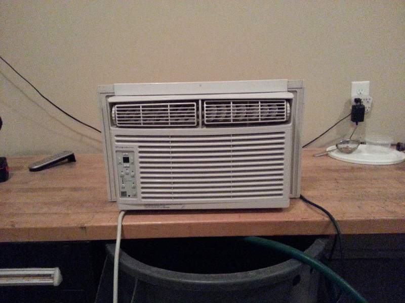

so i know that this topic has been touched on a bit from time to time. some have mentioned refrigeration units, some air conditioners, and an assortment of solutions that have been disregarded or failed. for whatever reason this hasn't been tried or revised im here to say that not only does it work it works better then i imagined. bellow you will find a sort of explanation and instruction along with some tips tricks and some down sides to this process.
also if your wondering where the idea came from it actually came for a forum on growing illegal plants. (no i don't grow or smoke it came up in an internet search.)
first you need yourself an old used air conditioner rated to the highest BTUs you can find without spending a bunch. this guy was gotten from Craigslist for $25. remove the front panel and filter screen *Note* there is a little white wire you can see on the front between the plastic slats, this is the temp probe for the controller and should be removed from the front of the unit. do not cut or unplug this wire but rather tuck it away within the unit
now find all the screws that attach the housing and go ahead and remove them as well as remove the outer housing and foam ducting that directs the air. *Note* you may have to remove the controller or loosen it to allow the housing to be removed, as it may be connected to the plastic now from here you have access to the cooling coils (the front facing radiator) it will be connected to the condensing unit within the system.
for the following steps be sure to exercise extreme care and be as delicate as you can to not kink or break an cooling lines.

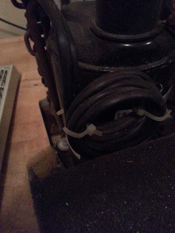

now go ahead and locate the coil of excess cooling line ( every unit has some additional line for whatever reason.) and clip the wire ties to allow you to extend them you should now have everything ready to begin extending and removing the cooling coils and radiator. be sure to use your hands along the lines to make gradual sweeping bends rather then sharp pinpoint ones to ensure you don't kink or bend out of space for pics one sec...

besides for having to be cautious of not damaging any lines you must understand that the cooling coil is made from aluminum fins and will rust. you cant really do much about this but i will say mine has been submerged for a few months now without any issues
as for cooling abilities: i had a garage at 90 degrees that got way up there as my electric boiler was running add to this the fact that my flute was throwing 5500watts into my cooling water tank upon water return this thing running about 10 min prior start up and all during the run managed to keep my take at 78*f without any problems
i dont have any pics of the finished product yet but i added ducting tot eh back side to vent out all hot air it made the garage much more enjoyable so dual purpose.
and there you have it water chiller for under 30 bucks

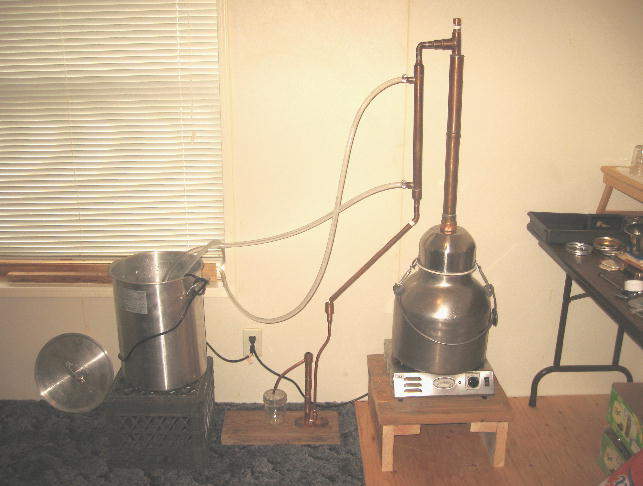

Here's my simple solution for Winter distilling (the rest of the year I do it outside with hose water connected to my condenser). It starts with an (approx) 8 gallon aluminum turkey fryer pot. In this pot, I have a pond pump from Home Depot, ($26.00), the pump is suspended near the top of the pot with some wire and attaches to the inlet (lower) port on my condenser with a clear hose. From the outlet port on my condenser, the hose runs to the window in my shop, where it rest's on the sill between the window and the screen. A piece of wood acts as a breeze barrier between the window and the sill and also allows the hose to go in and out of that space by being a couple of inches too short. The hose then enters the pot and is weighted to the bottom so that the hotter water exits there. Back to the suspended pump. It's at the upper part of the pot so that if the water get's warm even with the hose going outside in the dead of winter, I can add crushed ice to the liquid and the cold water will remain on the top where the pump is. I have enough room on the sill where I might end up making a small manifold which would allow the water to go through 2 hoses ( 1/2 diameter each of the main hose) for more cooling.

Re: my cooling water solution
Just took a pic of the setup, thought I'd share.
