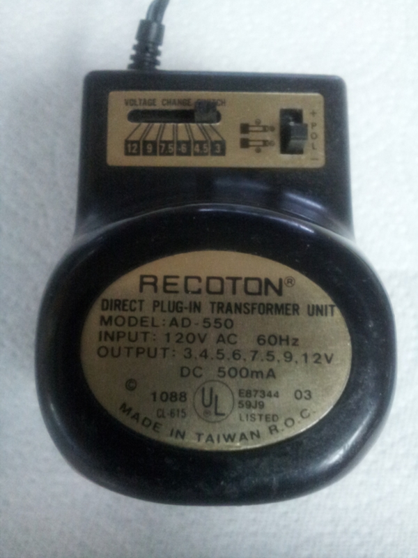

Found the perfect wall wart in my collection of junk for my fan power supply. Now I can adjust the fan speed by supplying a stepped range of lower voltages.
It is a multi-voltage converter, so I can select 3.0, 4.5, 6.0, 7.5, 9.0, or 12.0 volts dc output. The fan might not start with the 3.0 and 4.5 v settings though, but I will soon find out. There is a polarity swap switch too, which is convenient.
