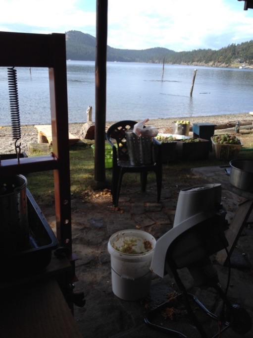

Since the apple orchards that I get my apples to make cider/brandy/grappa are on Stuart Island it was a PITA to take the press/grinder that my friend has out and return it each time so here is what I built for under $350.00 that has more than one function as it is tools that have other purposes. Before I begin I have to admit that I was pleased with the results. 3 of use put up 48 gallons of cider in 2 days including picking the apples.
Below are the tools I used where I got them and the cost.

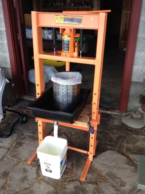

First the press is a 20 ton press I waited for the sale and coupons and picked it up for $120.00
Also pictured is a Turkey fryer basket that can be purchased for $19.00 on Amazon I already had mine so didn't cost any money. The basket is lined with a 5 gallon cloth paint strainer, Lowes sells them in packets of 2 for $5.99.
The basket sits in a heavy duty plastic tray that I purchased at Harbor Freight for around $8.00, I added a bar drain for another $16.00 to catch the cider and drain into buckets.
I had spare plywood that I made a shelf to set the tray and basket on and held it down on the press with clamps. Also cut a circular ring out of plywood to get an even press in the basket.

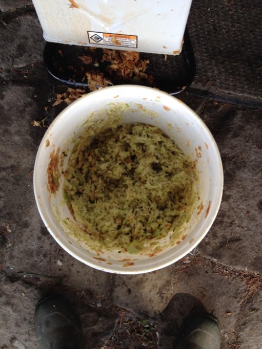

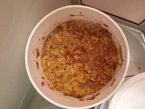

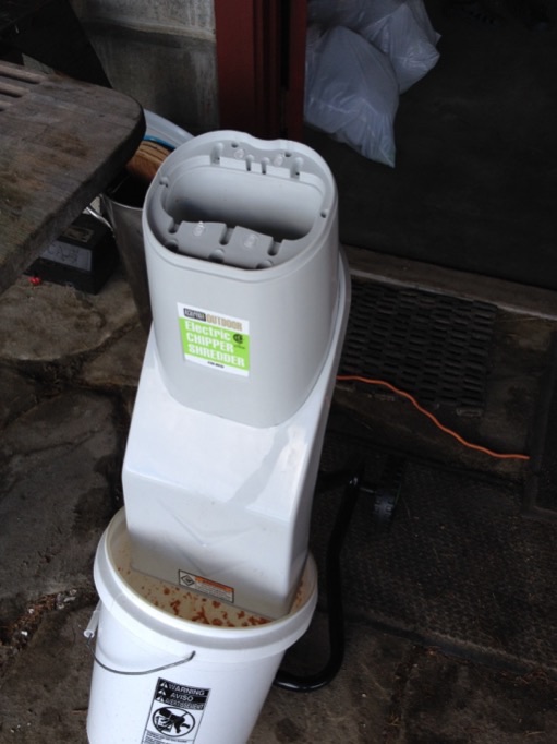

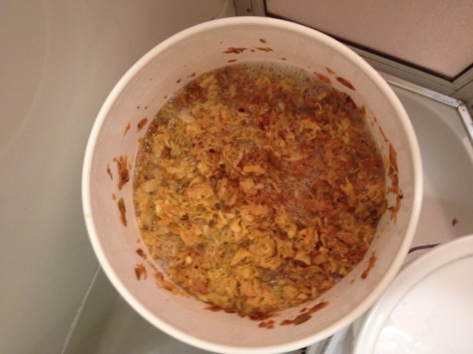

The chipper was around $149.00 at Harbor freight. It worked really well but had to take the protective cover off to get the apples in. It shaved it in perfect sizes the only complaint was that we had to quarter the apples that took a little time.
Here are a few other pictures showing the operation, a visitor that was looking for a free meal, and the beautiful place I had to work.
