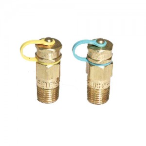

i want to use a petes plug on top of my boiler. to stick my gauge in,,,it will seal it off
i can get a SS petes plug,,,,but am concerned about the neoprene gasket inside the plug
any thoughts?
yakattack
Posts: 1755
Re: neoprene
Post by yakattack »
frodo wrote:i want to use a petes plug on top of my boiler. to stick my gauge in,,,it will seal it off
any thoughts?
Neoprene = no good. Sorry mate but you already knew the answer to that one. If you can remove it and make one out of PTFE and its all ss then hay why not. But I'm sure there are better solutions available.

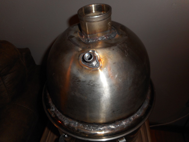

i have a 1/4'' coupling on top of my boiler,,,i would like a thermometer here
