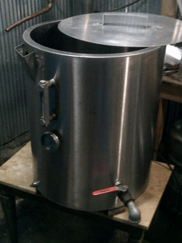

24 gallon electric bain marie
- Posts: 12852
I traded for this recently, I think it's made for melting candle wax and soap.
I'm not sure what to do with it.
For now I'll use it for a mash cooker and a heated fermenter.
The thermostat controlled heater is 115v 1500w that's probably too big for heating a fermenter.
Figure to use a controller to turn the power down.
In the future, I might make a water sealed lid and use it for distilling on the grain or pulp.

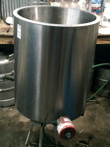

- Posts: 12852
Re: 24 gallon electric bain marie
Spent the morning cleaning old wax off the dadburn thing. Figured it was time to quit cleaning, and start playing with it.
Beyond a doubt, the 1500w heater would be useless for distilling. It's made for melting wax and holding it around 140f.
The pot is 24 gallons and the water jacket holds another 8, with 32 gallons total, saying the 1500w heater is slow and gentle is an understatement.
I'll probably bypass the mechanical thermostat and control the heater with a stc-1000 and a solid-state relay.
Figure it should make a great temp controlled fermenter for this winter

- Posts: 12852
I'm using water in the bain marie for mashing and fermenting.
When I use it for distilling, I'll need something with a higher boiling point than water.
There's a 18 gallon mash, made from corn and oats fermenting in it at the moment.
A side benefit of the water jacket is, it makes a good wort chiller also.

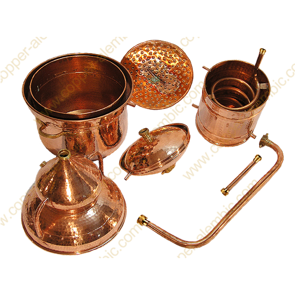

Shady, here are some pics from Al-Ambiq. It looks like their inner lip is higher than the outer. I thought the lid sat on the inner lip. Note the overflow tube at 4 o'clock.
EDIT spelling.
Brutal, do you mean the water seal overfills and overflows all by itself? More than you would expect from heat expansion? I have to leave my water bath about an inch low at the start to keep it from overflowing when it gets up to temp.
EDIT spelling.

Here is what Al-Ambiq says. http://www.copper-alembic.com/ns/catego ... category=9
It sounds like they are more concerned with the lid resting on the inner lip than about its height.
Code: Select all
What is unique about this still is that it uses water to seal off vapours from the interior, thus having no need to use any other sealing technique as in other models. The pot is built with two separate walls on the top side creating a chamber or corridor where the water is placed.
The inner wall is higher than the exterior one, and this is one of the essential elements of the water sealing system, as this wall must touch the lid to aid in sealing off all vapours. The complete system, independent of its size must be mounted on a perfectly level surface to avoid water spilling from the water corridor when in use.Distilling at 110f and 75 torr.
- Posts: 20865
- Location: New York, USA
That says the opposite... Perhaps they rely on evaporation...skow69 wrote:Here is what Al-Ambiq says. http://www.copper-alembic.com/ns/catego ... category=9
It sounds like they are more concerned with the lid resting on the inner lip than about its height.Code: Select all
What is unique about this still is that it uses water to seal off vapours from the interior, thus having no need to use any other sealing technique as in other models. The pot is built with two separate walls on the top side creating a chamber or corridor where the water is placed. The inner wall is higher than the exterior one, and this is one of the essential elements of the water sealing system, as this wall must touch the lid to aid in sealing off all vapours. The complete system, independent of its size must be mounted on a perfectly level surface to avoid water spilling from the water corridor when in use.

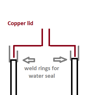

- Posts: 12852
Guess I should have started this post in the boiler section
Here's how I'll make a water seal for the bain marie.
Two strips of SS will be welded around the top for the seal and a copper lid will be made.
- skow69
- Posts: 3230
- Location: Cascadia
Yes. I think the question, at this point, is what supports the weight of the lid? Because that will heavily influence which lip is higher and therefor the fundamental design of the seal.

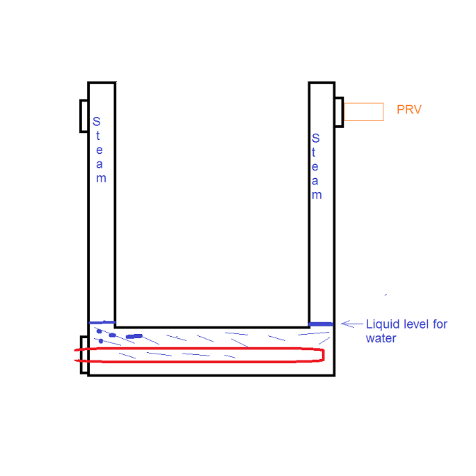

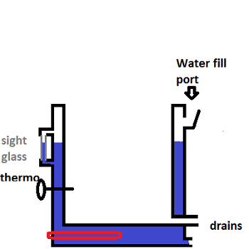

- Posts: 13299
The key is to only have enough water to safely cover the element. For this method you must have some remaining head space within the jacket that will allow for vapor. It is the vapor that gives the heating capability at distilling temps. Not the actual boiling water.shadylane wrote:I'm using water in the bain marie for mashing and fermenting.
1500 watt element would have no problem making enough vapor (steam) for a kettle that size. 1 bar will give you 250 degrees F.
You will have way more control if using water than you will have with oil. You will need a PRV no matter what heating medium you use.
Maybe not worth it to mod your vessel but seems like it would be no problem to replace that existing fill port with a ferrule so that you could pressurize the vessel.

- Posts: 13299
That's what the PRV is for.
15 psi (1 bar) is less than a bicycle tire and you'll likely only need a half bar.

- Posts: 12852
The thermostat is adjustable to 245f and I have a couple steam rated 15psi relief valves, one of which has been modified to open from 3 to 10psi.LWTCS wrote:Ah,, just saw where you said a thermostatic controlled element. Obviously that would have to go. But 1500 watts would work nicely under 1 bar with that small amount of heating medium to bring to temp.
There's also several pressure activated switches in my junk pile that could be used to shut off the heater before over pressure.
The water jacket on the Bain Marie could be easily made into low pressure boiler
But, I'd rather not post about building something as dangerous as a home made, unvented steam boiler.
