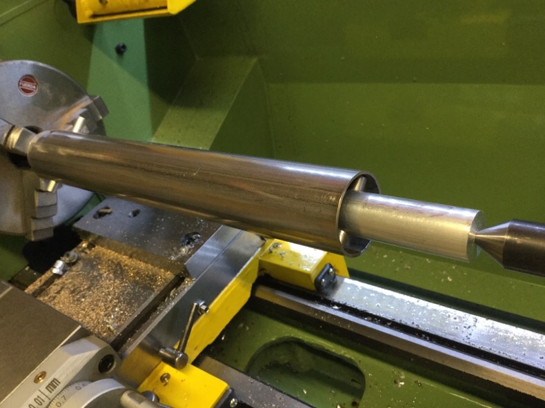

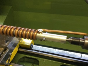

Just finished my double coil for my 1st build, a 2" bokabob reflux. The coil consisted of 5m 6mm copper tube and was turned on a homemade jig mounted on my lathe. I didn't power the lathe to turn, just turned the chuck by hand. The jig had an inner aluminium bar of 18mm and an outer form of 35mm stainless tubing. It worked really well, the coil took about an hour to turn, getting the salt out took 3 days. I attached the completed coil to our hose lock hose via a hose lock to 6mm barbed adaptors (eBay) and loads of zip ties to prevent it blowing off. If anyone wants anymore info on the coiling give me s shout. Here's a few pics.

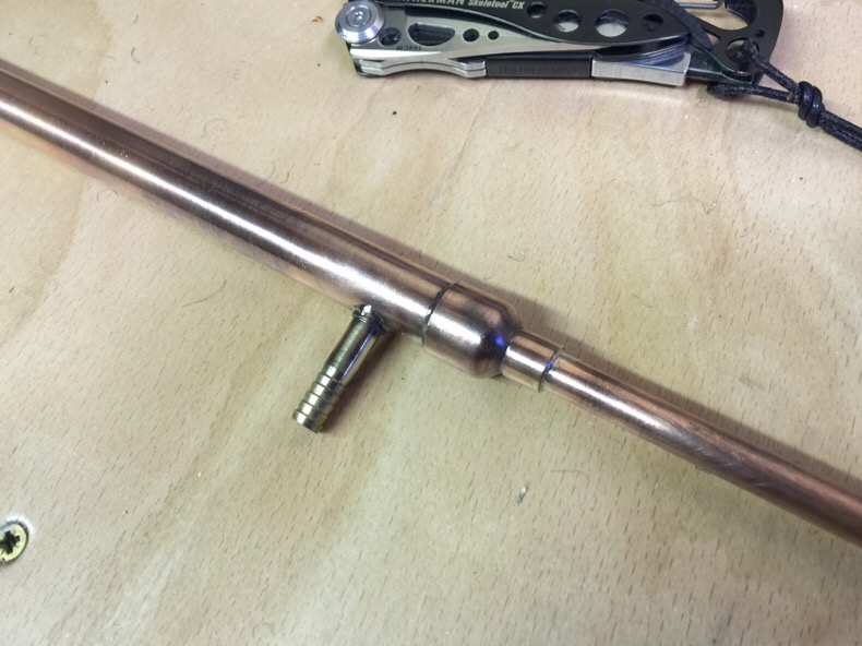

Mini Liebig now finished. I used 15mm outer tubing over 8mm inner and 2 15mm to 8mm reducers. The in/out barbed cooling tails are home made on my lathe. All silver soldered. I am going to have a go at copper plating the Liebig. Here's a couple of pics pre-plating.

So you're going to try copper plating (electroplating) a copper liebig...???Jamjargb wrote:I am going to have a go at copper plating the Liebig.

Yep, covers all silver solder seams and overflows. Liebig isn't to messy, but if it goes ok I will do liquid management section as that has a big chunky seam for the butt joint between cup and upright.

I tried once to copper platiesoft solder (Sn97Cu3). It didn't work, the solder oxidised and turned black before a copper layer was formed.

I read silver solder takes the plating. Will let you know.
