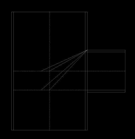

Here is a quick draw-up of a 2x2x1 Slant Plate VM head... It has two variations of plate angle and also two variations of plate depth, 50% and 33% (.25" past halfway for 2")... I have used this site for the volume calculations for various column sizes... For this application L=1, R=column radius, r=0, y=any arbitrary value... I just click Compute Volume and then goto step 4 and generate a table of incremental values... Every column size needs its own chart...
I actually like this idea better because it could be a bit tricky trying to get the elbow inside the Tee without a shoehorn or butchery... This issue came to mind while drafting the previous examples...
Okay, minime, off to your mad lab to do some testing...

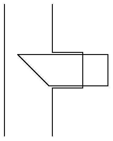

Another possible way to do that without using plates.
VM Stream Split.jpg (4.38 KiB) Viewed 8293 times
The vapour stream splitting ratio would be determined by two variables. One is the ratio of diameter of the take-off pipe to the diameter of the main column. The other is the angle of the cut on the take-off pipe.
Also, if the diameter of the take-off pipe is significantly less than the column, then there will be a gap around the sides of the take-off pipe inside the column. So the take-off pipe could project all the way across the inside of the column to the opposite column wall, and there could still be enough room at the sides for vapour to pass up to the reflux condenser.
Be safe.

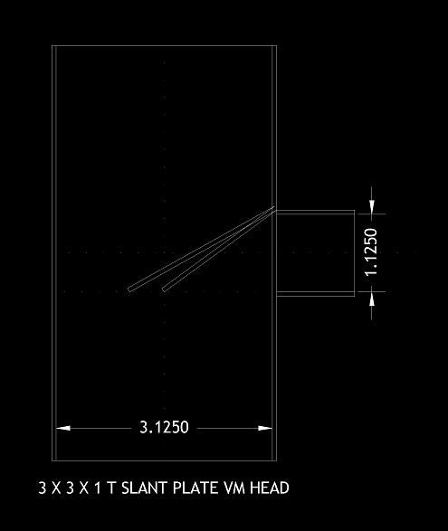

As HookLine pointed out, you could simply use an angle cut on the cross tube, but calculations would be more difficult and high take-off rates wouldn't be possible... Using the slant plate would be the most accurate method of getting a high percentage take-off rate...
I just sent this drawing to minime which shows both 50% and 70% volume plate placements... With a 3" T the 70% is at the 2 " mark, whereas the 50% is at the centerline...

I going to go with the 1/2 way point and the steeper angle. According to Rad's numbers that's about 6% more area than I have currently with the inverted funnel. I'm thinking reflux distribution will actually be better than my inverted funnel. All the reflux on the plate will be deposited to the centerline of the column and the other half will be evenly distributed. I already have a 3X3X1 tee to spare so I should be able to prove or disprove the concept within 2 or 3 weeks.
As far as equilibrium I have not encountered any problem with the current set up. My reflux condenser is two winds of 1/4 copper and then I soldered on a piece of 5/16ths for a third wind with the return running up through the centre of the coil. Works like a charm with very little restriction. It's only 8 inches long and I run it very hot with no vapors getting loose. It is wrapped in copper mesh also.
I really do think this could prove to be the ultimate VM design for efficiency, ease of build, and ease of operation.
Thanks again to Absinthoman for the idea

I really don't think that having the reflux drop exactly into the center of the column is as important as people make it out to be... Regardless of where the reflux drops, the rising vapor always seeks the path of least resistance and if that point happens to be near the column wall at a given height then that's where it's gonna go... The column should be of equal temperature throughout the packing volume with only minute differences caused by packing density discrepancies... Even industrial tray-based columns don't reflux down the exact center...
Sounds like minime is gonna have quite a collection of heads to use for his 3" column...
minime, I think your choice of plate configuration is the way to go... It would at least make a good base-point point from which to make future modifications...

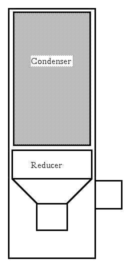

rad14701 wrote: you guys talking about reducers above the plate...???
MM and I have discussed something like this before:
VM head with reducer.jpg (18.84 KiB) Viewed 8211 times
Flare the big end of the reducer a bit to get a snug fit inside the column, forcing the vapour through the small end. Attach the reducer to the condenser.
You do not have to cut the column and solder a plate in.
An inverted reducer makes sure the reflux liquid is returned to the center region of the column.
You could put a bit of loose mesh inside the reducer 'cup' to help slow down and mix up the vapour as it hits the condenser.

what about a making a " sleeve' with your plate on it (slide inside collum) then could be rased lowerd or remove for altering.

HookLine wrote:The proportion of column that is blocked by the angle plate needs to be experimented with. Going to 50% like MM has gives a fixed reflux ratio of 1:1 (when the take-off valve is wide open). It is possible that 33% blocked would be better as this gives a ratio of 2:1, which is probably the minimum needed for clean neutral.
Thinking about that, I am wondering if we can assume that the ratio of the vapour flow down the two different paths will be the same (or very close to) the ratio of the cross sectional areas of the two vapour paths.
For example, just because the CSA ratio is 1:1 in MM's version, does that mean the vapour will split 1:1 (by volume)? Or 2:1 for a 33% blocked version?
