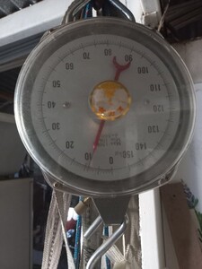

I do 20kg maize meal in ~80lt water. After filtering and pressing fermenting on grain I end with about 65 to 68lt of beer. The scale tells the rest.
