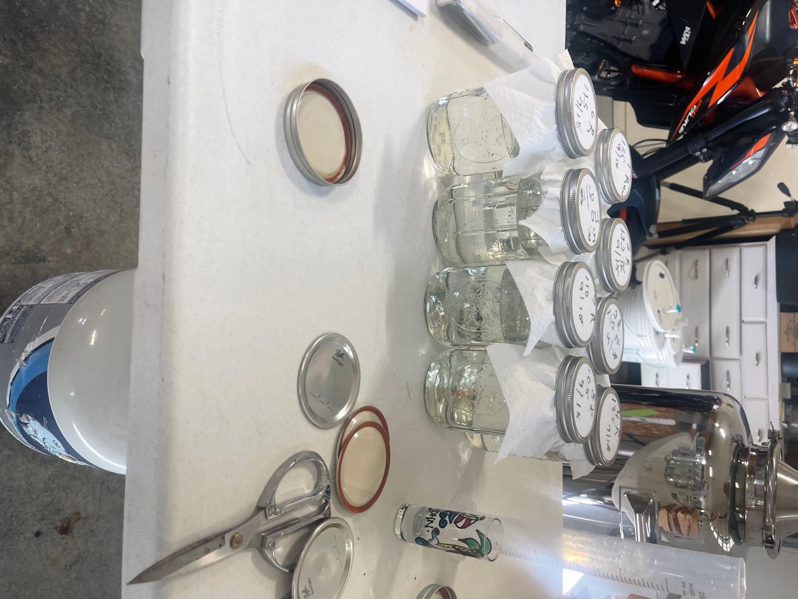

Post by realtree71 »
I wrote above “unconverted sugar” and got flamed. What i ment was i felt there was a potential for alot of sugar went unfermented in the original wash.
I used grade A molasses, 2 gal for a 10gal wash. I used yeast i happened to have which was a white wine yeast. I felt it may have stopped before reaching its potential. I ran it anyway. Got pretty good run from 20 gal total.
I felt the remaining spent wash or dunder tasted pretty sweet still so i threw some bakers yeast in it. Running the 2nd 10gal today. I threw in yesturday run back in and running slow. Getting good product today.
