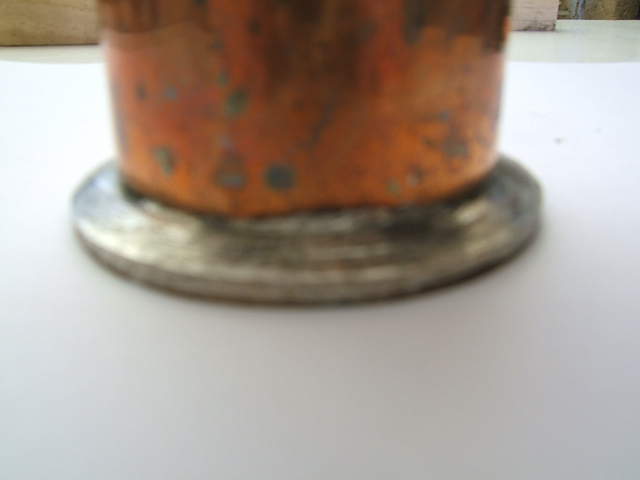

Just built my potstill and wanted to connect the column directly to the keg, I made the flange on 2" tube as described elswhere on this site. I then got a stainless steel pipeclip, jubilee clip or whatever you want to call it, I fluxed the flange first and then tightened the clip up over the flange, making a trough about 3/16" deep around the flange. this can now be filled up with solder and you end up with a flange which is a lot thicker than the original pipe flange. The pipe clip can now be unscrewed and being stainless and not fluxed it comes off easy. This thick flange can now be filed to the correct angle, similar to the excisting angle on the keg.
I have run my still twice now with no gaskets and no leaks, if you want to be really picky you can now face the flange with a sharpening stone,mine did not need it, but it depends on how good you made your flange. This will fit perfectly with a Tri-clip now.

olddog
Posts: 3618
Location: WEST OZ
Re: Easy flange
Post by olddog »
I cannot get my camera to focus on macro but see how this photo turns out

You still need to make the copper flange first, but build up the thickness and profile with this method.

It took me the better half of an hour, but I've got my copper flanged out...it's a little rough, but I think it will do the trick. I might need to use a cork gasket between the flange and the keg because of my rough metal working skills(or lack of). Gotta get a wire brush onto the top side of the flange since the sand paper can't get into the rough bits or the solder won't stick.
Thanks again olddog! great idea!

She's ugly!! and I've got some more shaping to do....but this is where I'm up to with olddogs easy flange.

I made another one, without the copper turning - just sstraight cast solder and ground her down. holds very well. I doubt the copper beating is necessary.

yeah. Here's my notes on the profile for the flange for proper mating with a tri-clamp... and casting technique
if you're hammering a ring out of rod or wire, or forming the end of the flange, the thickness of the copper at the outside edge should be around 1/16th of an inch. Scuff this off well with a brush or somesuch to prepare for casting.
Using the pipeclamp method (or the alu lined mason lid, wrap one or two wraps of solder around your pipe near/at the joint you want to fill. Heat up the joint to melt. If you are concerned that the solder isn't wetting certain areas, use a nail, or a piece of coathanger to move the molten solder. DO NOT USE MORE SOLDER THAN THIS!!!!
in practice, the actuall angle from the outer flange to the side of the pipe or fitting you are using should be very shallow, like between 15* and 30*.
If you overfill you will spend a lot of time with the file/beltsander/grinder getting it right.
I would consider the below picture the shoudler still a little steep for my tastes.
I just realized that my life is a very complicated drinking game...
