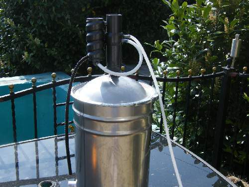

Here is my still, looking to improve and needing advise on how to or even if I can with this still, any input appreciated. :D

I borrowed one of those when I first started out and it got me hooked on making hooch.
Any plastics that come into contact with the spirit needs to be removed and replaced with stainless or copper.
You've got it so use it to try an Uncle Jesse Simple Sour Mash (UJSSM)
It should give you a really nice neutral..
Just don't use turbos and be happy with say..... a 25ltr wash and 4kg of sugar with bakers yeast.
Give it a go and then see where that leads you.

You need to add at least one metre of packed column underneath that little stumpy CM thingy to be able to make anything close to neutral. :problem:
You can make some fine whiskey-ish product with UJSM and DWWG washes though. :thumbup:

What would you suggest, replacing the little column if so are there any plans on here for such a change. :D

As aqua vitae mentioned, you can vastly improve the overall performance of that rig by adding a packed column extension... Several members have already done so and were happy with the results... And, as I recall, no other modifications were made... However, the addition of a reflux centering ring, placed right about at the top of the column extension, would most likely also improve reflux performance and take off rate...

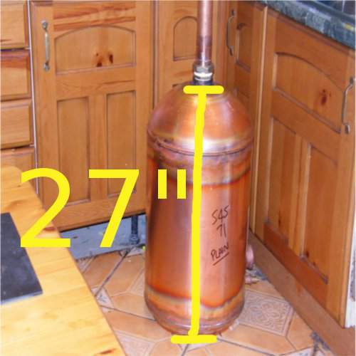

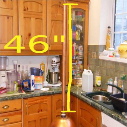

My new still :D

Looks like a Boka two reducer design? Nice! It should make a very nice neutral. Tell us about the boiler. Looks like it was welded up from parts.

Boiler was custom made, UK company 27" 16 wide :D

Very nice Waylan. 23 gallons. Excellent boiler size. :thumbup:
Edit: excuse me, didn't notice the domed top. Around 20 gallons then. Still excellent. :thumbup:

She's a 15.39 gallon - 70ltrs :D

waylyn wrote:Boiler was custom made, UK company 27" 16 wide :D
Would you mind sharing contact info for company. UK folks may be interested. That is a nice looking rig you've put together.

Sorry for the delay, the cylinder was made by a company called gledhill (http://www.gledhill.net/" onclick="window.open(this.href);return false;" rel="nofollow) but they don't deal with the public direct, you will have to find a local plumbing supplier who has dealings with them and tell them the size you want e.t.c :D

The still is working a treat now I have a phase angle controller :D
