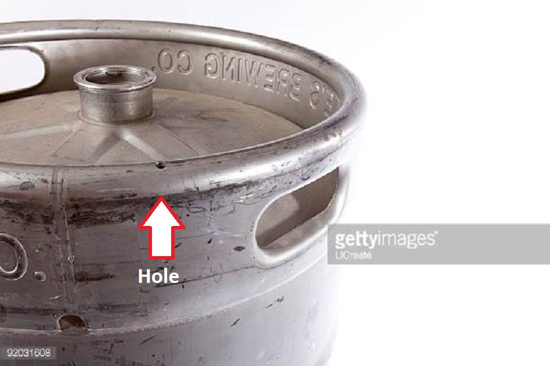

So i have a question about the keg stills, whats the best way to clean them? I have black spots in the bottom of mine (mold probably.
pfshine
Posts: 3106
Joined: Thu Jan 19, 2012 10:59 pm
Location: Vegas
Re: if you use a keg you need to read this
Post by pfshine »
Weird place to post that question but OK. Lots of things to do. Put some soap water and a chunk of chain or rocks in it and stir/shake the hell out of it. Or if its just mold put water a mild non sudsing detergent in it and boil it. Lots of other ways, just think about it. If you use oxyclean make sure to rinse with vinegar and water.if you have more questions you can pm me.
hawgwrench
Posts: 222
Joined: Tue Jan 20, 2015 5:08 pm
Post by hawgwrench »
Holy Crap man....I'd have shart myself if I'd been anywhere around that. Never thought of this, gonna check now. If it aint got holes it gonna have in a minute...should the holes be .38 or .45 sized?

Goes like this...
"Safety notice:
While brewing in the public parking lot of Hopman's Homebrew Supply in Waterford Michigan for National Homebrew day one of the homebrewer's brew kettles (converted sankey keg) exploded with such a bang my ears are still ringing! It is my luck that I happened to be visiting his brewery when the bomb went off. The burner frame was destroyed and the keg tipped spilling 10 gallons of boiling wort onto the pavement. Luckily no one was burned by the wort. Here's what we know:
This keg was manufactured differently than every other keg we examined, the rolled steel lip at the top and bottom was welded solid with no holes drilled in it. No other keg was welded solid and all of them had 4 holes drilled in the keg rim. This is the rim that contacts the ground when the keg is in upright position.
The keg built up pressure in the rim until the rim exploded
We don't know what caused the explosion inside the enclosed rim - air expansion, moisture, maybe some unburned propane (not quite sealed in that case). It exploded after boil was well underway.
What we do know is it is dangerous and you should check your kegs! If there are no holes - drill some"

KYMountainMan wrote:I want to see pics. Was someone boiling inside a keg with the valve still intact or something? I'm not understanding the keg issue. I need pics.
The bottom lip of the keg that looks like a tube and goes all the way around was welded shut. By heating with propane, the gas inside expanded until it blew. See this link for pictures of a welded bottom, http://www.homebrewtalk.com/showpost.ph ... stcount=42" onclick="window.open(this.href);return false;" rel="nofollow

If I remember correctly... this post was about a beer brewer who used a keggle to mash and a heating source (propane...?). Either way, on the rolled outer edge of the keggle there were no holes in it. This caused the air that was inside it to become superheated during cooking and explode..sending hot wort all over the floor. No one was hurt but the implications are obvious. The moral of the story... check your keg and see if the rolled edge is perforated somehow... I cut most of the top of mine off and my bottom has holes.

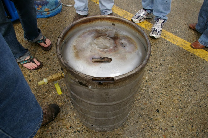

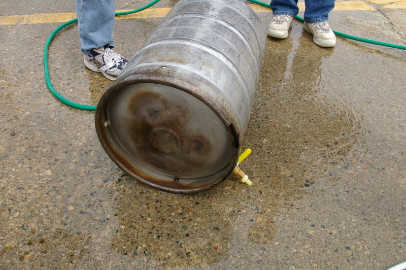

EXPLOSION! On National Homebrew Day - Converted Keg
Safety notice:
While brewing in the public parking lot of Hopman's Homebrew Supply in Waterford Michigan for National Homebrew day one of the homebrewer's brew kettles (converted sankey keg) expoded with such a bang my ears are still ringing! It is my luck that I happened to be visiting his brewery when the bomb went off. The burner frame was destroyed and the keg tipped spilling 10 gallons of boiling wort onto the pavement. Luckily no one was burned by the wort. Here's what we know:
What we do know is it is dangerous and you should check your kegs! If there are no holes - drill some! Here's some pictures
Time bomb in the background
Boom! Here's the keg that fell
Distorted burner stand
Everyone standing in wort, looking at the failed keg
Shrapnel
Stamping on the keg if it matters
