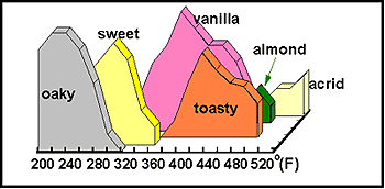

http://homedistiller.org/graphics/oak_aromatoast.gif" onclick="window.open(this.href);return false;" rel="nofollow

The method of toast you use will be dependant on what you are after. Some folks love the alligator char and its rich bite, while others are looking for more subtle flavors.
This graph should give you a better idea of what to shoot for in what you want for your liquor.:
I find this one quite interesting.

rad14701 wrote:Nice chart, ScottishBoy...
Ahem...yes.. Same one tater posted exactly one minute before me...;)
Sorry Tater, dont mean to be steppin on your peaches.
