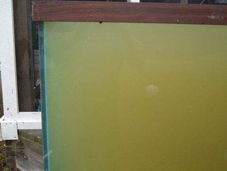

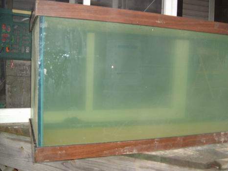

If the molasses is nearly neutral, it generally was made so with calcium hydroxide(lime). The calcium hydroxide reacted with sulfuric acid, will give lots of calcium sulfate. When using aluminum sulfate, which is a mild buffer, you get a reaction that creates calcium sulfate and aluminum hydroxide by simple replacement.
You missed on part of this reaction that is quite significant. The resulting aluminum hydroxide(nearly completely insoluble) combined with the calcium sulfate(generally insoluble) removes the negative charges from most suspended solids. The negative charges repel each other and causes them to distribute evenly through the liquid.
Removing that charge causes them to fall due to gravity. This causes almost all suspended solids to first coagulate due to the sticky aluminum hydroxide, and then flocculate due to the calcium sulfate. All the stuff falls to the bottom and can be racked off. This reaction is quite fast even in cold liquids and the coagulation/flocculation assisted by gentle stirring happens in minutes. The settling in a still solution takes only 10s of minutes.
Here is a couple pictures of my using aluminum sulfate, that I make at home to clarify pond water that has a lot of mud and algae in it. This algae is such fine particulate that I am not able to successfully filter it with a sand filter but I can remove it from the water with the Aluminum sulfate.
First picture is the before: The second image is after adding 10 grams of the stuff to this 75 gallon tank. that is about 10ppm.
I stirred it for about a minute to get the flocks to join up and then it settles. Notice all the sediment in the bottom. The tank stayed fogged up and the glass has a slight bluegreen tint. The water is crystal clear looking in from the top. I am sure the wash would have to be made pH neutral before the addition of the aluminum sulfate because aluminum hydroxide only exists as a solid at or near 7 pH. Lower and it reverts back to reverts back to aluminum sulfate and higher and it changes to aluminum ions and the base such as sodium hydroxide.
I prepare it by reacting aluminum foil with sodium hydroxide(violent). Neutralizing the sodium hydroxide with hydrochloric acid makes a white, gelatinous substance in salt water. The gelatinous substance is aluminum hydroxide. This is what is commercially know as DiGel the antacid. The gelatin can be washed to remove the salt water solution by using filter paper. The gel combined with a very small amount of sulfuric acid dissolves it completely to aluminum sulfate and water. It can be dried to make a powder. This is the stuff that clarifies water so well and is used around the world as a water clarifier. The homemade stuff is nearly flavorless.
In a pinch you can use ordinary Alum form the canning or spice section of the grocery store. It is usually ammonium aluminum sulfate but it works the same.
