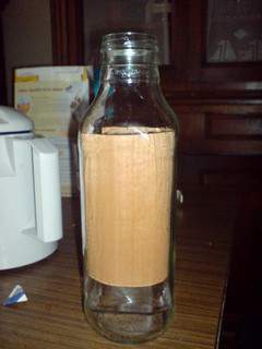

Can anyone see any problem with using firewood for aging? I'm based in Poitiers, France and the main source for firewood here is Limousin oak. We've got about a face cord of firewood here, all oak, which has been outside for about 4 or 5 years now. I've split some bigger logs and taken out the heartwood which I'd like to use for aging my apple distillate to do a pseudo-Calvados.
The other idea I had is to use oak veneer sheets. My girlfriend does marquetry restoration on furniture and she's got lots of sheets of veneer. No oak at the moment but it's easy to get. It's more or less as seen on this site: http://www.originalmarquetry.co.uk/veneers.htm" onclick="window.open(this.href);return false;" rel="nofollow
I was think of aging in 1L glass bottles with a sheet of french oak veneer rolled up and put through the opening as shown in the attachment. Obviously I'd use the veneer without a glue backing, no dead horse in my booze!!!
Any comments or suggestions would be appreciated.

Either should work. It'd be interesting to see a comparison.

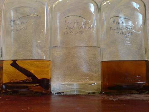

I've gone ahead with the firewood and, after a bit more forum browsing, I'm also using some pear that I had lying around after spring pruning. I split both woods into little sticks, tinfoiled them, and toasted at 200°C for about two hours. Damn it smelt nice! The oak package gave a huge whiff of vanilla when I opened it up. It's been about 8 hours now and the oak bottle is a nice pale golden colour and the pear is an amazing pinkish peach colour. The oak is a little cloudy but I'm pretty sure it's because I tossed in a piece that was burnt a little too much, I fished it out, hopefully a coffee filter should get rid of it.

The left is on pear wood, the right is on oak; there's about a liter in each, and a bit more raw spirit, which I'm keeping as is for blending. The oak looks a lot darker in the photo than it actually is. Oh, it's all at about 45%ABV.
If I try the veneer idea, I'll post details.

You will want the hart wood sapwood will be bitter

if you toasted that veneer if you can would almost be like turning your bottle into a 1L barrel. It seems like it would be a pain to get it out of the bottle to reuse it though.

use a set of tweezers, reach in and grab it , turn tweezers and twirl it small enough to come out the topgs_moonshine wrote:if you toasted that veneer if you can would almost be like turning your bottle into a 1L barrel. It seems like it would be a pain to get it out of the bottle to reuse it though.

After a bit more thought, I've decided to try a couple of bottles of the veneer thing. I'm using wide-mouth bottles for ease of removal. I can't toast the oak before putting it in the bottle because it gets too brittle to roll up, so I'm going to put it in and toast the whole thing, bottle and all, in the oven. As long as I'm careful with the cooling down of the bottles it should be okay.
