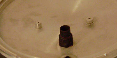

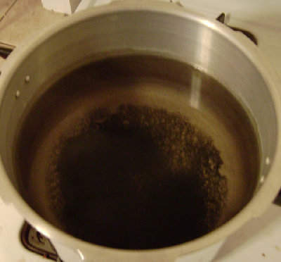

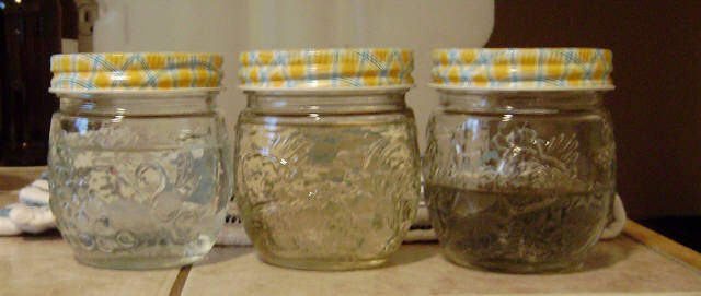

I brewed a really nice rum wash and stripped it with good results via my pot still, the entire run was clear and the hearts tasted very good with a little carry over from the heads. tonight, I reloaded to make a spirit run using my column for a little better separation and after achieving equilibrium we went straight to disaster. the foreshots were clear and nose burning powerful and then the run started to put out some nice smelling, lightly rum flavoured (drops on the spoon) followed by a small column flood and full blown disaster, the distillate starting taking on a greenish brown and got progressively darker and foul smelling at which point I shut down and started researching ammonia, except when I opened the boiler after it cooled some, I smelled rotten eggs.
I loaded the still with crystal clear stripped wines 5L ~ 40abv with about a TBSP of kosher salt, the boiler's aluminum, stainless scrubbers and copper everything else. I'm only guessing that the reaction has to do with the salt or more likely the caking agent in it, I did a complete teardown and the scrubbers looked good but the reaction was definately with the copper, it's almost black! obviously I've done wrong somewhere and ruined a very promising 20L of rum wash.
any ideas where I went wrong and is there a way to clean up my still internals and return it to service or should I rebuild what can't be scoured completely?

Wow...!!! I've never seen that much crap in spirits and also never seen that kind of separation in the boiler... The wash remaining in my boiler usually looks pretty much like it did when it went in and I've never had solids form and drop to the bottom...

I'm also wondering if the salt may have promoted a galvanic reaction between the aluminum boiler and the copper column, the column flood may have been what it took to complete the circuit?
