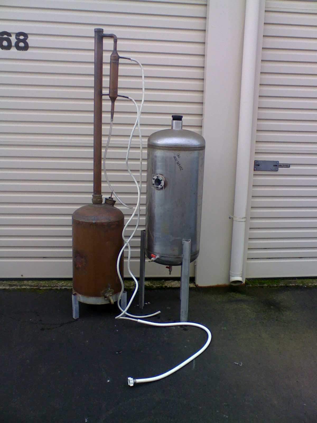

OK, here it is. It's not connected to anything here, but you get the drift. When I want to run a batch through I cart it into the laundry and connect the condenser hose to a tap and let water trickle through. The good stuff drips from the clear hose into a flagon. I heat it with a single gas ring controlled by a needle valve, letting it run up to temperature fairly quickly before turning it right down once the drip starts. There are three stainless steel scouring pads up inside the column, fairly evenly spaced. I find them best to keep things steady.
Only other thing is a thermometer in the top of the column so I can keep it within range. A slight creep up or down a few degrees doesn't seem to hurt, once the heads have gone through it's just a matter of waiting eight hours or so until the oily stuff starts to drip. You can see it against the light, when the good stuff is crystal bright with a good fruity nose. Unmistakable.
The other stainless steel tank is a fermenter that I use for winemaking. The whole crush is fermented to 3-4 days in the marc in a big Sulo bin, then filtered into the tank to finish. When that's done I leave it awhile to settle then rack it off into plastic drums before racking it again into flagons.
