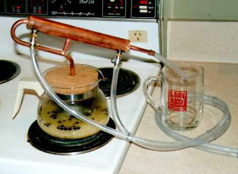

OK, I want to build a small still similar to the one on the main site under flavouring and gin (I am adding the picture from the site). My question, is how hot can a glass coffee pot go without cracking. I have a small electric stovetop burner that I would like to use.

Post by rad14701 »
Bushman, is it really worth risking having hot high proof alcohol splashing onto a hot element if the glass pot were to break...??? Surely you can do better without laying out a lot of cash...
I've always thought that picture looked like there were dead flies floating in kitchen grease... :lol:

Post by Dnderhead »
I thought a hops back would really work nice for such things but $$$$$$$$,
a tea kettle,coffee pot or a pot would be much cheaper,

I know but I have most of the parts laying around and I just want to experiment. Found a pot that is made for a stove top plus I have a portable small one burner electric stove top that I can run and not make a mess in the kitchen. I will probably build something better in the future but just like to tinker and learn new things.

Post by The Baker »
rad14701 wrote:Bushman, is it really worth risking having hot high proof alcohol splashing onto a hot element if the glass pot were to break...??? Surely you can do better without laying out a lot of cash...
Now if you had a thin, wide metal bowl that you could put on the element under the pot, of capacity sufficient to hold the contents of the coffee pot.....

Post by cob »
Bushman wrote:OK, I want to build a small still similar to the one on the main site under flavouring and gin (I am adding the picture from the site). My question, is how hot can a glass coffee pot go without cracking. I have a small electric stovetop burner that I would like to use.
that picture contains a perfect example of composite cork. cob

That's a great idea, I agree with rad that we cannot be to safe. I will make sure I put every safety feature I can think of before making the run.
