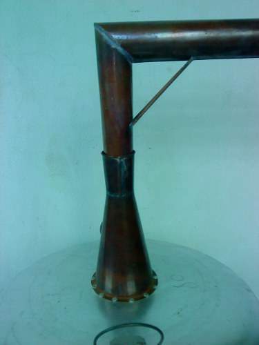

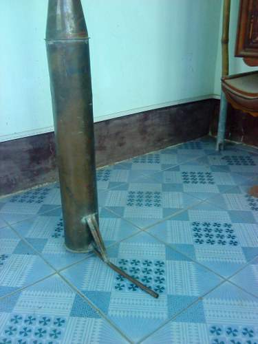

Ended up buying the 80L pot still. What do you guys think? Still have to make some kind of a system for cooling this thing though

Interesting design, vhuy... All you need is a water bucket to submerge the product condenser in with the product output sticking out through the side of the bottom... Use whatever method that works best for sealing the take off to the bucket...

Thanks! I have to find some method to keep it cold and stable. I will use wood as heating, so I guess the heat will easily spread, and I need something to ensure it won't be too hot. Will try to make a water run tomorrow to test it. Will look at the temperature then. I read that people often underestimate what it takes to cool the thing of.

vhuy, if heating with wood it is easier to use a bed of coals than open flames licking up at the bottom and sides of your boiler... When I used to heat with wood I had a separate area where I burned the wood down to coals and then shoveled coals in and out from under the boiler as needed... I also used ash to reduce any unwanted flames from igniting off the coal bed... Food for thought...
