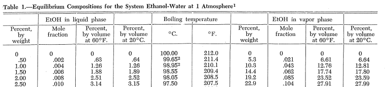

Maritimer
Posts: 716
Joined: Sun Jul 01, 2012 6:09 am
Location: Nova Scotia, Canada
Re: Temperature & ABV Relationship Charts
Post by Maritimer »
Hi eStill,
There is a collection of data from 1957 that is quite good:
http://136.145.83.33:8000/jspui/browse? ... Herminio+M" onclick="window.open(this.href);return false;" rel="nofollow
Here is a .xls of the main table that I used OCR to convert to text:
Brau.zip
(13.21 KiB) Downloaded 521 times
PM me if you'd like to discuss things. I've got tons of data.

eStill
Posts: 150
Joined: Sun May 08, 2016 1:36 am
Post by eStill »
Maritimer wrote:
Brau.zip
No headers on any of the columns makes deciphering a bit of a struggle. Can you help, please?
Maritimer
Posts: 716
Post by Maritimer »
Hi eStill,
If you download the other file, which is a scan of the original document, you'll see the headers. The introduction is also very interesting.
M

Maritimer
Posts: 716
Post by Maritimer »
Hi eStill,
That's weird. I checked the site before posting. Anyway, here is the header you need:
(Click to see full size.)
Keep checking, though. This document is very useful.
M
