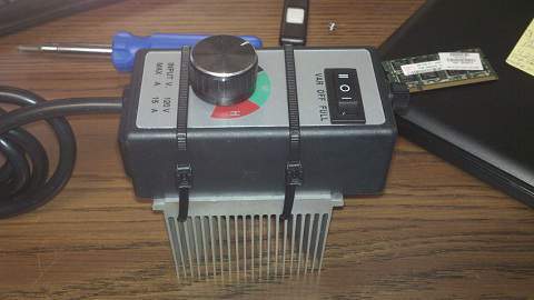

Build one like prarriepiss . huge heatsink and used thermal paste. We will see how it works this weekend.

@ white_likker1,
Hope you have used mechanical fasteners (screws or nuts and bolts) to physically firmly secure the heat sink to the triac chip and not solely relying on those tie wraps to secure the triac chip to the heat sink. To effectually transfer the heat generated by the triac chip to the heat sink the triac chip and heat sink needs to be securely fastened together with mechanical fasteners.

Coaster wrote:@ white_likker1,
Regards,
Coaster
You better believe it. I work on PC's and Pro Audio Equipment everyday. The last thing I need is a blown chip or output processor.

By the way, I learned a little trick today. I put the controller heatsink side down on the divider of my stainless kitchen sink while running. It provides a whole lot more thermal transfer and keeps the heatsink a lot cooler.

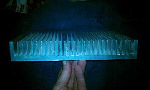

Nice job white liquor. Getting the heatsinks to mount on the back of the case is a little tricky. The zipties aught to work for a while. :thumbup: As long as they are high heat ones. :lol:
And that's not a huge heatsink. This is a huge heatsink. For my next controller. I have two of them. :mrgreen:

Prairiepiss wrote:Nice job white liquor. Getting the heatsinks to mount on the back of the case is a little tricky. The zipties aught to work for a while. :thumbup: As long as they are high heat ones. :lol:
geez, yeh that is huge.... :esurprised:
