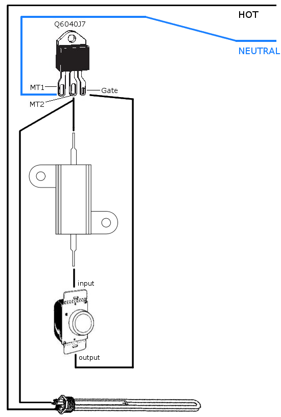

i used this. somewhere in the thread someone stated that MT1 and MT2 were backwards. Is this diagram correct or the two reversed?newerbrewer wrote:WW: This diagram helped. Alot. Think it was posted by pinto... cant find the thread so will repost.

Don't go by the diagram, go by the spec's for the Triac you are using... A 300W dimmer (600W works too) will drive any sized Triac because the load on the control circuit is minimal...rugbytaco wrote:i used this. somewhere in the thread someone stated that MT1 and MT2 were backwards. Is this diagram correct or the two reversed?newerbrewer wrote:WW: This diagram helped. Alot. Think it was posted by pinto... cant find the thread so will repost.

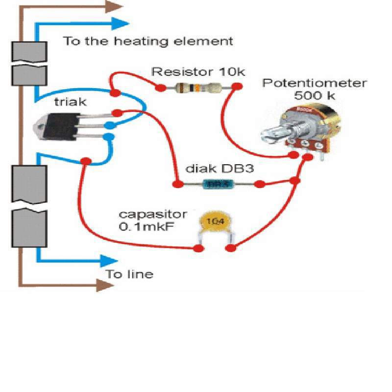

Im reading and wondering if Im planning on building the circuit for a 240v, 4500 watt heating element to use on my 50 l beer keg, using the TRIAC BTA26-700B what is the wire gauge I have to use on the circuit to wire all this, do I have to use the same wire thickness as the one on the 240v line ?
Thanks.

Blue wires are high load... Red wires are for the control circuit and are low load so thinner wire can be used...Cmdte wrote:Im reading and wondering if Im planning on building the circuit for a 240v, 4500 watt heating element to use on my 50 l beer keg, using the TRIAC BTA26-700B what is the wire gauge I have to use on the circuit to wire all this, do I have to use the same wire thickness as the one on the 240v line ?

For blue and brown wires I'd recommend 12AWG wires. Red wires can be much thinner.Cmdte wrote:Im reading and wondering if Im planning on building the circuit for a 240v, 4500 watt heating element to use on my 50 l beer keg, using the TRIAC BTA26-700B what is the wire gauge I have to use on the circuit to wire all this, do I have to use the same wire thickness as the one on the 240v line ?

Cant seem to find the ceramic capacitor, is this any good ?

Nope, they are rated 50v but you need 400vCmdte wrote:Cant seem to find the ceramic capacitor, is this any good ?

It must be .1uf, NOT 1.0uf... There is quite a timing difference between the two in these circuits... For a 240V controller you should use 400V rated capacitors...Cmdte wrote:Yeah, I know what you mean, but I have no idea the one we see in other controller designs, can you point me inthe right direction here ? also, do I need 0.1 uf , 400 volts ? or can it be: 1.0 uf 400v ?rad14701 wrote:I received an order that had those tiny capacitors instead of what I wanted and they did not work at all for their intended purpose... I ended up sourcing my capacitors locally instead of trying to get them replaced... You want something larger in physical size, similar to the ones you see in other controller designs...

Ups... why 400?sambedded wrote:Cant seem to find the ceramic capacitor, is this any good ?Cmdte wrote:Cant seem to find the ceramic capacitor, is this any good ?
Voltage at capacitor never be more then 40v because DB3 opens triac when at capacitor will be 36-38v . After opening of triac, voltage at capacitor goes to zero. Capacitor 0.1uf 50v will be good for this.
