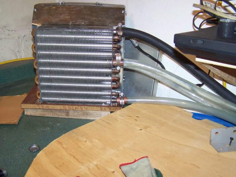

What kinda temp drop do you have accross that radiator? Im just wondering if it has enough cooling capacity to go with a smaller resevoir. Ive been thinking about running a closed system myself. I have a well, and water is not an issue. But it wouldnt hurt. And a small radiator is not hard for me to come by. NFR. Nice Fuggin Rig

The condenser is 9" x 9" x 3" and had 30 passes. I split it in to 14 passes for the dephleg as well as 16 passes for the combined product condenser and bypass line. The Depheg water was about 2-3' C lower than the vapor being taken off for product collection (78.3'C). It was returned to the 45 gallon drum at around 1 - 2'C above the barrel temp(started at 22'C ended around 27'C). The same can be said for the combined product condenser and bypass line. The room air was around 22'C at the start and 28'C near the end(small room 10' x 8'). Starting amperage after warm up was 14 and 17 at end of run.MuleKicker wrote:What kinda temp drop do you have across that radiator? Im just wondering if it has enough cooling capacity to go with a smaller resevoir. Ive been thinking about running a closed system myself. I have a well, and water is not an issue. But it wouldnt hurt. And a small radiator is not hard for me to come by. NFR. Nice Fuggin Rig
For the size I was very impressed. The coil is from a commercial freezer. It was the condenser coil. The fan was from a different unit and bastardized together. Not sure what rig your running but the 45 gallon drum is lost of capacity. I dont know enough about what Im doing yet to advise if it could be reduced in size. But Im sure with a bigger coil the water could be reduced by half.

Please excuse my ramblings here, I don't know as much about thermo dynamics as some here, but, I thought a "radiator", as in a device to dissipate heat, was always more efficient if manifolded, like the multiple cores in a traditional car radiator.
A device to introduce heat was better designed as a continous run, such as an a/c evaporator. This is designed to boil the refrigerant gas, therefore better as a continous run.
Maybe a continous pipe from the outlet to the inlet of a car engine would work. If it was as efficient, or effecive as a multi core style, maybe more car makers would go that way. That said, I don't know if you made a pipe as long as you could to fit in the equvilent space of a radiator, weather it would be as efficient. Obvously, car makers are not going to use that much copper.
As I said, just ramblings, because at the end of the day, a bucket works for what we are doing. I just mention it as I am running an old 4 cylinder nissan radiator on a 50 litre tank. I'm splitting the water into 80 cores for one pass. Comes out pretty cool, tank warms up and stays there for the run, even at 34C ambient temp.
Please don't get offended Sungy, just dropping it in there. I don't think it matter how a guy does it, as long as it gets done

The key to it all comes down to flow rates and temperature differential between mediums. The more circuits the coil has the slower the flow rate will be. There for the fluid will be in the coil longer. Your radiator has 80 circuits. Suppose it was flowing 40 liters a minute and you have 80 circuits 12 inches long. This will give you a flow rate of 1/2 liter per Minuit per 12 inch circuit. Now we add the fact that the car is driving at 60 km hr. Thats a lot of air going past the coil at a consistent temperature. So a single pass works well.
Now an A/C condenser is a single pass. Mine is split into 2 circuits. This allows for the control valve to only send what I need to the dephleg (very small amount of water coming out just a few 'C below product temperature). That water is sent to the upper circuit of the condenser( 12 passes each 10 inches with the return bend that's 120 inches or ten feet). Now for the tricky bit. The flow rate varies depending if I am in full reflux or collection mode. suppose we are in product take off mode. That is 1 liter approx. from the dephleg into the top circuit changing from 76'C to 23'C per minute. In full reflux mode it is 25 liters approx. from the dephleg into the top circuit changing from 28'C to 23'C per minute. The air across the coil has a slower face velocity than your car.
Like you said "I don't think it matter how a guy does it, as long as it gets done"
The biggest test is to see how close to ambient temperature you can get your cooling water to be. This is referred to as approach temp. Take your water temp and subtract your air temp. The result will tell you if you are rejecting enough heat. Low numbers (1 or 2) are good heat transfer rates, high numbers mean you need a bigger coil. This works for all condensers. Dephelg condenser would be vapor temp minus cooling water out ( full reflux the numbers will be high and indicates excess flow) for product take off the numbers will be close say 2-4 "C. Leibig condensers compare product out temp minus cooling water out (not sure what the spread is for these yet) .
Sorry to ramble on folks. Just trying to help.

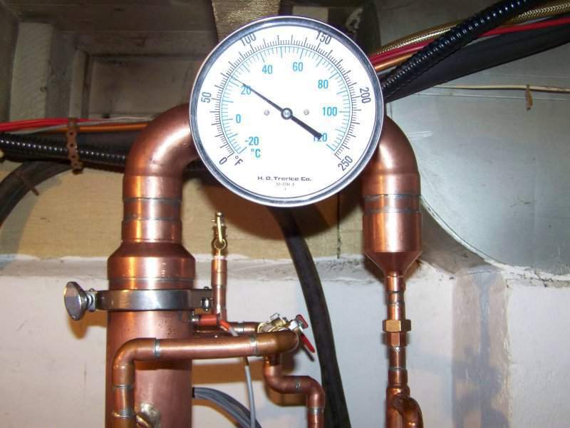

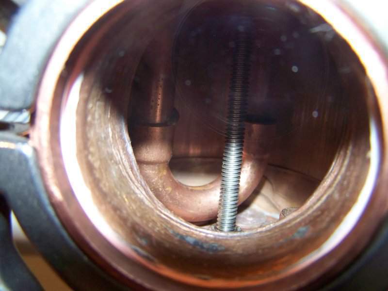

So here are the modifications to my still.
Fist is the cooler fan circuited and plumed in.Here is a shot of the return bends I am usin for traps I made a funnel from a 3 inch to 1.5 inch reducing coupling and a 1.5 to 0.5 inch reducer. Here is the new version of my spring loaded paddles for stirring my washes. They slide right into the hole for the air lock. The ring stops the paddles scoring the bucket lid hole. I also added a thermo port to my column just because it looks so cool. I re cleaned every thing and she's ready for her next run. Got another Birdwatchers fermenting and a bag of sweet feed is going to be next.

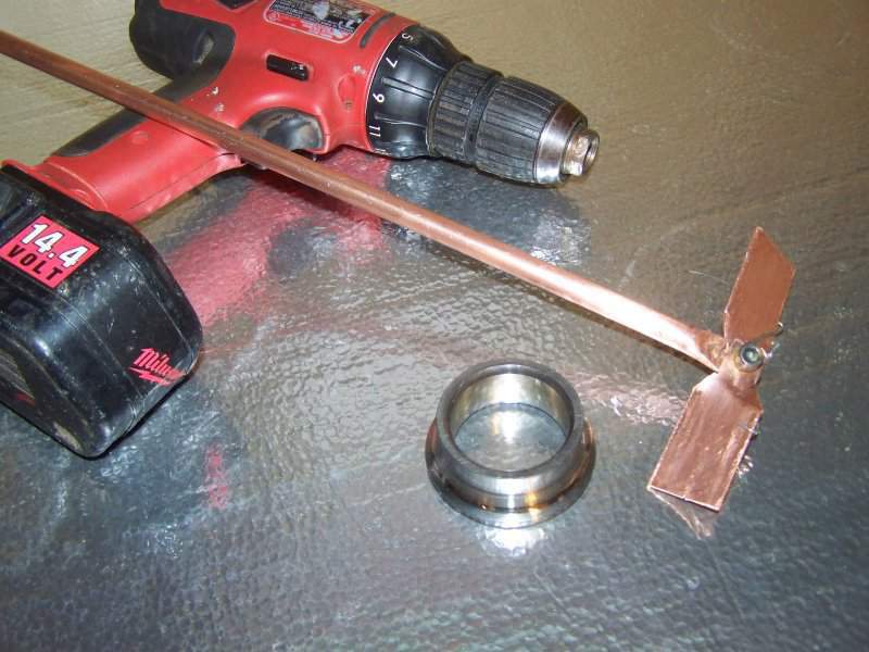

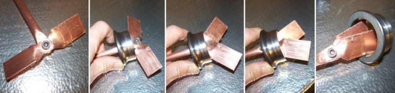

Thats clever,,,but why do you feel the need to stir?
- Sungy
- Posts: 570
- Joined: Sun Dec 11, 2011 4:31 am
- Location: Great White North
Re: 3 inch valve plate design
Birdwatchers recipe requires daily stirring. Just doing as directed.
I take it you dont have to stir other recipes?

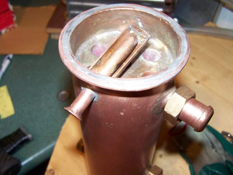

Here is the sensor shield ( condenser is upside down). This cover should stop the condensate from distorting the actual vapor temp. Here is the fermentor box ( my basement can be quite cool ) Im using a desk lamp for heat 40 watt bulb. Some Birdwatchers in the buckets on day three at 1.032 SG. Started at 1.092 SG

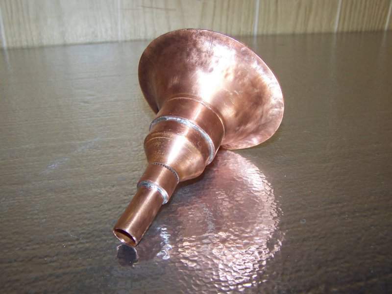

Hi all.
Spent last night running a batch of Birdwatchers. For those following the build the U bend traps performed very well. For a three inch column the performance is great ( on a larger size column I would increase the down comer size). Most 4 inch columns have a sweet spot at around 18 amps from what I have read. This 3 inch columns sweet spot is 14 amps at 240 volts. This is what I hoped for. Smaller column diameter and less power input to run it makes the basic design concept more economical to build and operate ( if you don't go control crazy like I did. Totally not required but cool lookin ).
On a side note. The sensor shield for the lower dephleg temp worked well. But with the sensors in wells I still have a 3'C error caused by thermal lag. Heat sink paste will help reduce the error but the only way to truly get accurate readings it to have the sensor in direct contact with the medium being measured.
Now for the run. I spent much more time finding the column equilibrium at the beginning of the run. Once stable for 30 mins. I reduced the reflux valve to 39% and away we go. 188 proof for the first two jars then 185 proof for the rest for the run until the tails. Then at 80 proof no reflux and crank the heat to collect the deep tails to be added back into the next run. Total run time was 5.5 hours to run 12 gallons and collect 8.5 liters.
Well that's it for now. Gonna make up a batch of sweetfeed this afternoon.

I have picked up 3 dial thermometers. They are 1/4" stainless sensor tube with a 1/2" MIP thread also stainless. Just like the one in the video. My next build will be all manual control with dial thermo gauges. All will be in direct contact with medium being measured.I liked mash rookies idea of the cork for the thermo probe, but after mucking around with sheilds that I couldnt get to stay still, I decided to run without them. It seemed to make little difference to the actual reading, but further from that, the reading was only so helpful. I still use cork, with the thermo probe pushed through it.
I picked up a new thermo gun with with a laser pointer for $30. This has been more helpful in letting me know how much the temps don't matter. Well' not that the don't matter, they just happen.
But in the end, its how it tastes
As for the infra red thermometers you will find they read differently if it is a painted or a smooth, reflective surface. I have a few of them and all have issues with reflective material like copper pipe. For a more accurate reading try wrapping your copper pipe with black electrical tape.
