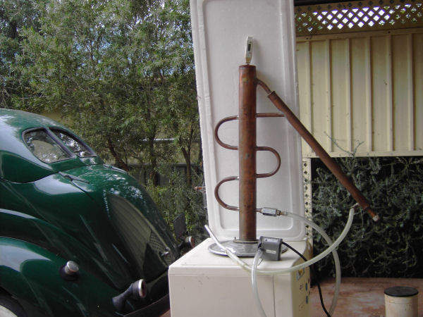

Here is one i made...
And the car to get away in....
Cheers
PJ
Titus-a-fishus
Posts: 363
Joined: Sat May 22, 2010 3:03 pm
Location: Narnya....narnya business
Re: What still to built or buy?
Post by Titus-a-fishus »
Poppa Joe wrote:Here is one i made...
Cheers
PJ
Looks like you suffered the same book I did.
While the cooling tubes are not used by me
The pot still actually works quite well
Can get up to 75% with a little time and practice
Cheers
TAF
