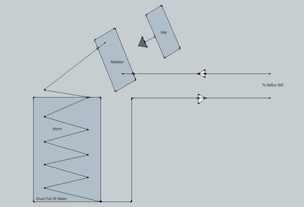

I don't know if this has been settled yet or not but here is my idea of what may work for the OP. If I understand correctly he was running a reflux still so here is an idea to use a radiator and a worm in a barrel and a fan. I would possition the fan and radiator so the air moving across the radiator blows on top of the water in the drum. Oh I forgot to include a pump in the drawing but you get the idea. Don't know for sure that it wold work but don't see any reason it wouldn't. Hope this helps, Al
Click on the image for a better view.

Re: Hi tech cooling - saving water during a drought?
i have been using one for a few years, works well keeps the water at 30-35c on a average day in Oz..
its a small refrigeration coil and fan, i was thinking about adding evaporative cooling but there was no need.
- Posts: 676
- Joined: Fri Jan 06, 2006 4:21 pm
pic from fan side..
