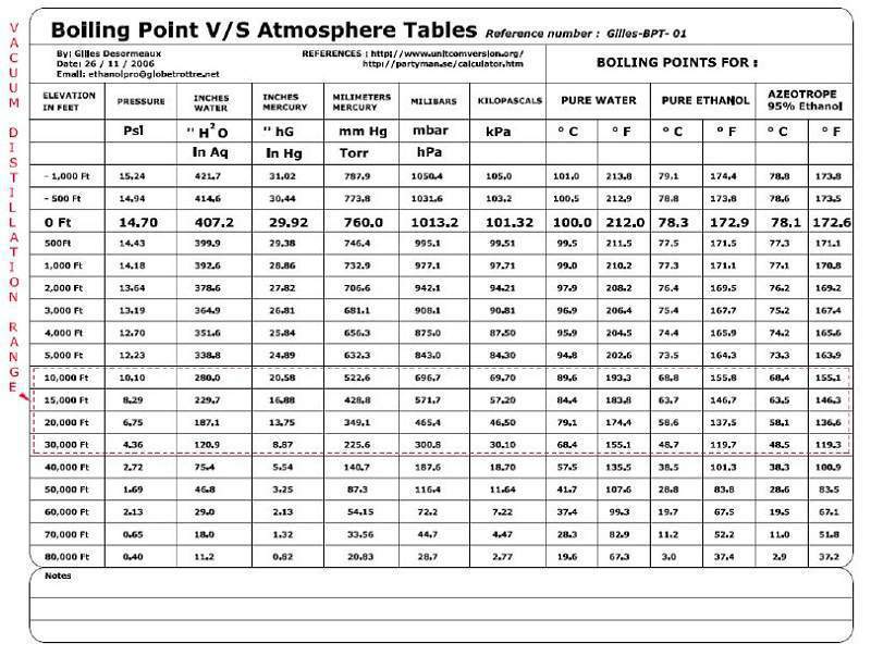

A couple of things I have learned in my first couple of runs -
Altitude affects your boiling points so be sure to take that into account. Chart found here: http://homedistiller.org/forum/download ... &mode=view
Hydrometer temp correction. As my run progressed, my cooling water heating changed the temp of my distillate in the parrot. You need to adjust to the calibration temp of your hydrometer: http://homedistiller.org/forum/viewtopi ... =2&t=19391
Here is one for the 60° Brewhaus and Widder alcoholmeters: http://www.brewhaus.com/CategoryGrid4.a ... goryId=142" onclick="window.open(this.href);return false;" rel="nofollow
