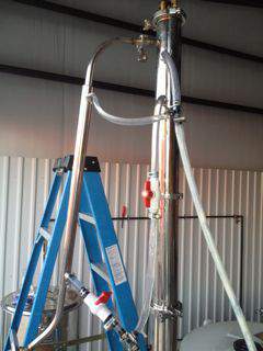

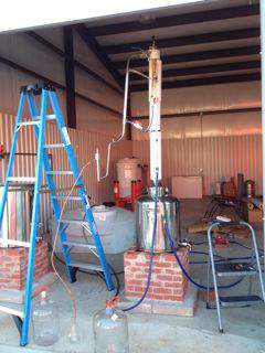

Hi folks. I'm looking for a little help troubleshooting my modified CM still.
We have a Mile Hi still to which we have recently made many of the suggested modifications:
--lengthened column
--insulated column
--packed column with copper mesh
--added manifold
--added ball valve to output (between dephlegmator and product condenser)
--replaced rubber stopper with ferrule/endcap (with pressure gauge, pressure safety release valve, and thermometer mounted to it)
--welded parrot and copper tubing onto output
Picture of setup attached.
We ran it for the first time with the modifications yesterday, doing a spirits run on some vodka we had previously stripped. Worked great, we were pulling 92% pure product out at around 78.5C vapor temperature. But we only got about 1/3 through before running out of time. So we returned this morning and fired it up again.
Today, without any changes to the configuration, it is behaving quite erratically. The temperature at the top of the column never stabilized once it boiled up, fluctuating rapidly from 60 to 78C. Once some liquid collected in the parrot, every few minutes the parrot would "burp" and shoot out a geyser of product (not good around open flames!). This behavior continued, even with coolant flow to the dephlegmator at full, and the burner set as low as possible.
We took the whole thing apart, verifying there was nothing obstructing flow through the column/product condenser/parrot/output tube. Also took apart coolant manifold and verified water flow was unobstructed through both condensers.
Any ideas what might cause these wild temperature and pressure fluctuations? The *only* difference between yesterday and today is the process started with a gallon less liquid, and what was there had a lower ABV.
Thanks in advance for any advice you might have.

GhostfaceStillah welcome aboard.
Please step over to the welcome center and give us an intro.
Sory I didn't catch this post sooner.
When you fired it back up. Did you run it in 100% reflux again to get the column to equilibrium? How long did you let it equalize?
What are you using for heat?
Starting a run back up the second time after shutting down in the middle of a run. Isn't as easy as firing it up with the same settings you left off with. You will basically need to start fresh like its a new run. Including a smallish foreshots cut.

GhostfaceStillah
- Posts: 19
- Joined: Thu Oct 14, 2010 8:51 am
Re: CM Still Output Improvement Mods Mile High / Brewhaus PS
Thanks for the response!
Well, this still has never truly seen 100% reflux even with coolant going 100%. The shotgun condenser inside just doesn't have the surface area to really do it, in my experience. Replacing it with a coiled copper condenser is something we have talked about.
At any rate, we had the coolant water running at full the 30 min or so it took to boil, at which point this immediately started happening.
200k BTU propane burner. We have a good regulator, so we can turn it *way* down when not boiling up. A 25 gallon charge usually takes us about an hour to boil.
My current operating theory is that since we started at a warmer than usual temp (it never cools to room temp overnight) and the boil up took half the time, the proper temperature gradients and equilibria never established along the length of the column. Probably causing a pocket of liquid at the bottom of the column, leading to bursts of pressurized vapor coming up the column.
I should and will intro myself over there. Been absorbing from the forum for a while, never posted.
Prairiepiss
- Posts: 16571
Even if you turn the heat down you can't get it to go into 100% reflux?
The pic is so small I can't tell. Is it a 2" or a 3". You said shotgun condenser. I never knew milehigh to make a shotgun condenser? They have the old ones with the tubes through them and the newer ones with the jacketed condenser. And I think a forth one with like a cold finger in the center?
But I think you should still be able to with full water flow through the reflex condenser. Turn the heat downbti a point you would have 100% reflux. It almost sounds as if your throwing to much heat into it. The insulation will make a big difference inbthe heat needed to run it. Compared to no insulation.
GhostfaceStillah
- Posts: 19
No. I suppose I could buy a smaller burner so I have more granular low-temp control. But never had a problem until now, and didn't have a problem with the first run after making the mods (ie the run from the cold start). Could've been just lucky the first time.
>>Is it a 2" or a 3".
3"
Sorry, typing faster than thinking while reading about other condenser designs sends the wrong input to the output! It is the design with the tube through the middle.
Could be. Strange that it has never been a problem until now...I guess that insulation really does make a difference! A smaller burner is certainly an easy and fairly cheap thing to try. I'm also going to let the liquid fully cool to room temp and fire it again to see if that really matters.
Thanks for the insight.
>>Is it a 2" or a 3".
3"

Do you have the coolant supply going to each condenser or through one to the other?
GhostfaceStillah
- Posts: 19
We have separate flows to each condenser. Pic attached.
Prairiepiss
- Posts: 16571
Ok went back and checked what mods you did.
Do you have a vent on your parrot?
And how tight did you pack your column? It should be kinda tight but you should be able to breath normal through it. Can you hear liquid bubbling in the column? Flooding? It would sound kinda like its boiling in the column.
