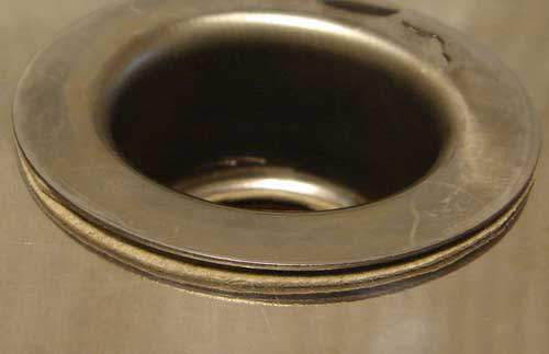

Here is what I did:
Made a hole in the lid and screwed a stainless bathtub sink. Cut from plain cardboard (no gloss and color), gaskets to seal between the lid and sink.
Cut a cardboard gasket to seal between the sink and column nut.
Use 100% cotton thread to seal the thermometer.

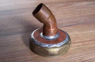

If you want to use the boiler as a potstill, a simple adapter like this one does perfect job.
