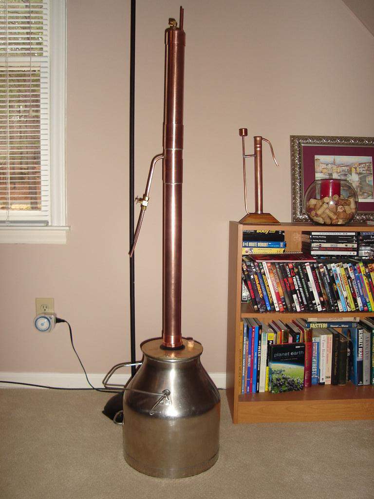

Hey Yall,
I thought you might enjoy a look at my handywork .
It's a 36" x 2" dual plate design bokakob that i'm going to use on that milk pail.
I also threw together the little parrot in the bookcase too (just to brush up on my soldering).
I need to come up with a way to seal the lid and then I'm going to do a water test.
...then I'll get a turbo/sugar wash going for cleaning purposes ...I guess I could toss a pint of that distillate in my car's fuel tank (home-brew Dry-gas)
.....then on to some UJSM
:D
'preciate all the knowledge yall share on this forum.
(now let's see how that picture turns out)

Thats a nice looking setup. It looks very similar to mine. Do you have an electric heater in the milk can? I have the taller milk can and after 3 to 4 experiments with gaskets to seal the leaks, I tried the flour dough in desperaton. It worked like a charm. Have made about ten runs now and no leaks. Good luck with yours, I am sure you'll have a great time with it.
Nemo
Posts: 20865
Re: my 36" bokakob
Post by rad14701 »
Looking good, NcHooch...
Might have been nice to have had a few more inches of packed column and a few less of condenser section, but if it works that's all that matters... You can always add a column extension if required...
Keep us posted on your progress and the stills performance...
Good luck...

Thanks guys,
I was sorta confined to the 24" column and 12" condenser since those 2 pieces were the only copper available around here...Like you said Rad, easy to add another foot of need be. I'm planning to either use a 1500W hotplate, or borrow the propane burner from the turkey fryer. :wink:

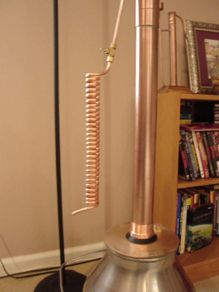

Here are some other pics, maybe they'll be helpful for other builders.
Here's my coil , I set up a simple winding jig and just wound it without any filler .....it flattened out quite a bit but still passes water ok. I plan to pack round the outside with copper scrubbers
I may need to wind another if it doesn't work as expected
Here's the business section with the collector plate
This is the lid, I'm not exactly sure if the lid is copper or brass, so I'll pickle it just to be sure. that's a threaded copper union with a Viton seal and a copper nut underneath
Here's a look at the 45 degree collector plate.
this is the first coil I wound on my jig and discovered you need more than 13 feet to make a 10" double helix (lol)...So I thought I'd use it for a distillate cooler instead.
:ebiggrin:

I love this little still, it does everything I need it to do, but the take-off it a little slow, so the other day I set about correcting an issue that has been present from day one. When I wound the original condenser, I wound the first layer and had such a woody I just turned the corner and wound the second coil right on top of the first ...and you can see how small the diameter is compared to the 2" tubing on the old one:
here's the new one:
it has a nice gap between the coils and fills the condenser section of the bok much better than the previous coil without the need for packing scrubbers around it. I feel this'll promote better vapor flow up toward the top to the column and produce & shed more condensate ...and we all 'preciate more condensate, dont we?
part of me wants to install a small sight-glass below the reflux plate just to watch the ethanol pour down into the packing....yall are havin way too much fun with those flutes :)

NcHooch, the new double helix condenser looks much better than the original... You should definitely see an improvement in performance...
