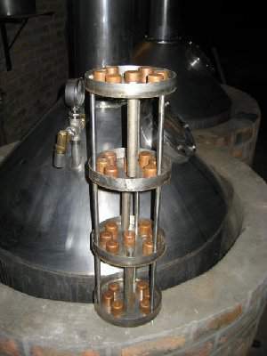

Thanks x7 for your kind tip but as Thorn already mentioned, the built of stills isn't really MY problem.
I don't go too much for high ABV but for taste, so most of my stills are pot stills, here what's inside the new 6" towers.
That doesn't mean that I have no problems, mine are the local ambient temperature which makes fermenting in big vessels difficult, but that's another book.
