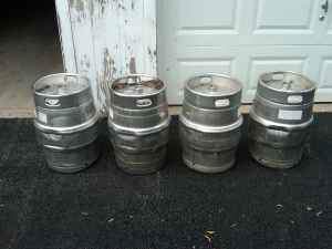

Not sure where I should have posted this, in the material safety forum or here. I figure it's a pretty novice question so here is probably good. I'm talking to a guy online who's selling some kegs he has sitting in his garage. I know aluminum probably won't work as a boiler but stainless will. I asked him if they were aluminum or stainless and he said he didn't know. How could I (or explain to him) tell the difference? Aluminum is way lighter than stainless but this dude doesn't seem to know what he's talking about here so I'm sure he won't be able to tell from weight unless he had another keg to compare it to. Does it say on the bottom or anywhere on the keg?
Thanks guys.- Tater

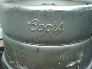

The kegs in that picture appear to be stainless steel... I don't think Coors has used aluminum kegs in a very long time...

Look on top of the keg. There are usually numbers and letters on there. I have a Coors keg that is stamped 304L. 304L is a grade of stainless steel. If you see that stamp it is stainless. Other grades of stainless are: 303, 304, 316, 316L, 2205, 904L. Good luck!
