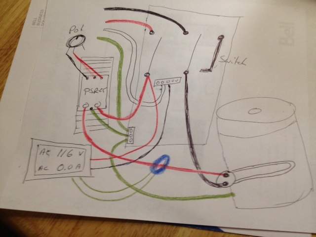

This is my wiring

Wow do I feel stupid now!!
When I clipped the breaker back in, I missed the proper slot by one space and of course I had both poles clipped into the same bus
All fixed and running right now!!!
