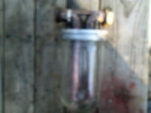

In the past, before I found HD, I copied a plan from " those who shalt be named" (ripoff artists).. It used a mason jar as a thumper. Now I am not in anyway condoning this behavior, but,,, I ran a large pickle jar for almost a year with no problems.. However, I read about the ability to have the glass shatter and spraying 180 degree flammable liquid all over you, and I quickly changed my ways. The plus side is I had a visual on what was going on in my thumper and gathered from the speed and sound of the bubbles, the speed that I should run my still. The down side. THIRD DEGREE BURNS AND DEATH BY FIRE!!!

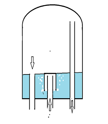

Made a glass thumper, instead of using a jar, I used a glass globe from an explosion proof light.
The globe is made out of borosilicate glass and has a usable volume of a little over 1/3 gallon.
Planned on putting fruit in it for adding flavor.
It didn't work. The damn thing kept flooding and I didn't like the flavor it added.
Thought about turning it upside down, adding a down-comer back to the pot and using it as a glass bubble plate.
