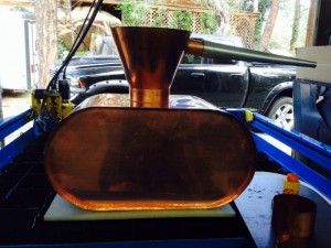

Check this submarine out.
ShineRunnah
Posts: 313
Joined: Tue Nov 04, 2014 11:44 pm
Re: small scale sub pot
Post by ShineRunnah »
shadylane wrote:Check this submarine out.
Shady, there's no wood on the sides of that submarine, so its really just a different shaped copper pot. Pretty nice too. I'd be proud to call it mine.
Halfbaked
Posts: 3401
Post by Halfbaked »
Thats the one that I posted about. He made wood sides for it for the look. I like it better with all copper but it looked really good with the wood.
