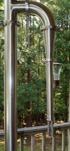

I built an over sized dimroth for my stripping setup. It knocks down anything I can throw at it and was pretty simple to make. Not saying that you need this size, it's a bit of overkill. It will work at any angle though.
http://homedistiller.org/forum/viewtopi ... u#p7317223

Looks good Hound Dog. What size is the CSST? I looked at your link and remember the thread, but didn't see anything about the size of the CSST. I have a long coil of the stuff and I think it's maybe 1/2" ID, don't know. I think DAD300 also uses one and I've always been intrigued by the simplicity of it.
Anyway, nice job.

I have some questions about your setup.
The condenser has a length of 3 ft ok? how long is the flexible used to fill all the consensor?
No copper mesh?
Why the reduction of the column is before elbow and not after?
The column is a 3" inches one? what is its length?
Thanks!!!

S-Cackalacky wrote:Looks good Hound Dog. What size is the CSST? I looked at your link and remember the thread, but didn't see anything about the size of the CSST. I have a long coil of the stuff and I think it's maybe 1/2" ID, don't know. I think DAD300 also uses one and I've always been intrigued by the simplicity of it.
Anyway, nice job.
I used 3/8" because after the corrugation it is a larger diameter and 1/2" is a real tight fit. I don't know what length was used since it comes in 25 ft. rolls, probably a good 15 feet. I put a little stainless scrubbie in there too.

srpompon wrote:
Hound Dog wrote:I built an over sized dimroth for my stripping setup. It knocks down anything I can throw at it and was pretty simple to make. Not saying that you need this size, it's a bit of overkill. It will work at any angle though.
Hound Dog,
The condenser has a length of 3 ft ok? how long is the flexible used to fill all the consensor? Yes the section is 3 feet. The coil is way overkill with like 15 feet of 3/8" to make it. Just because it came in a 25 foot roll and I could :thumbup:
No copper mesh? There is a little stainless scrubbie in there. No copper is on the descending side only stainless. The ascending side and the boiler are copper. That is plenty.
Why the reduction of the column is before elbow and not after? Cost. I have a three inch column still and 3 inch parts. I didn't want to buy the sanitary fittings in 3 inch they are way more $$ and there is no benefit.
The column is a 3" inches one? what is its length?The column is a 16" section of 3" I have as an add on section to use here and with my column.
Thanks!!!

One nice thing about a dimroth, coolant flows through the coil so it can be smaller than 1/2" 12mm.
If the vapor flowed through the coil, for safety reasons it would have to be 1/2" or bigger
