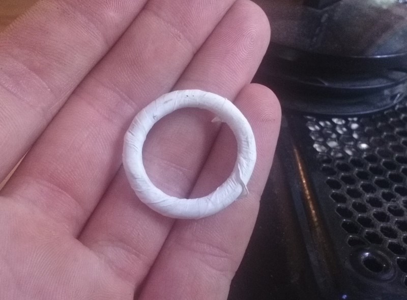

- bearriver
- Posts: 4442
Re: ptfe o-ring
With solid PTFE, yes. Pure PTFE can come in multiple forms. Some is hard like most plastics, some resembles the silicone used in brewing tubing, and some resembles stiff compressible string cheese. I got this PTFE gasket material from Inertex that stretches length wise but does not get thinner as it is stretched.sltm1 wrote:Solid PFTE doesn't compress so you'd have to mill both top and bottom surfaces perfectly flat along with both sides of the "O'" ring gasket. Then pray you don't accidentally mar any of those surfaces or you'd have to do at least one of them again.
Anyways my point is that a few wraps around hard PTFE gasket with PTFE tape will do the trick when making a low pressure gasket. The tape will allow for imperfections.
This is a spare for one of my bulkhead drains, wrapped in PTFE. All of my hard PTFE tri clamp gaskets are wrapped in PTFE tape as well.
